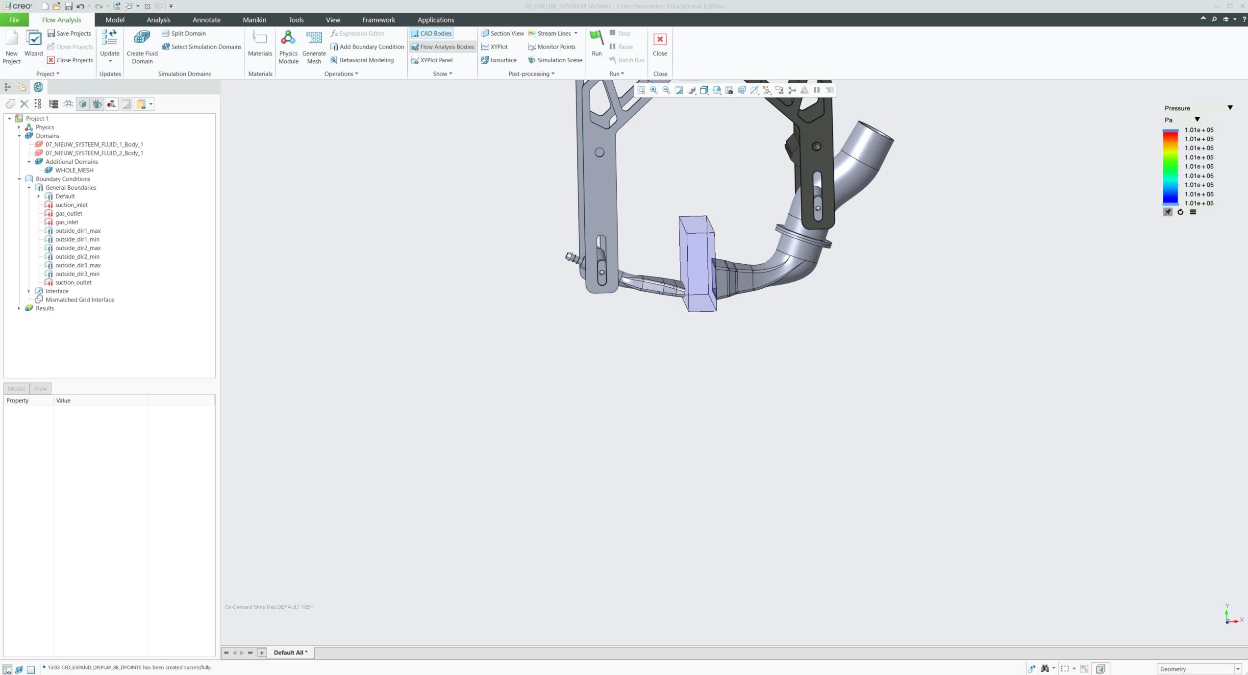

Hello everyone,
I am currently working on a Creo Flow Analysis for a vacuum system. I was able to successfully set up an internal flow simulation, but I am facing errors when trying to include the ambient airflow around the nozzle.
What I have set up successfully:
  • Internal flow only:

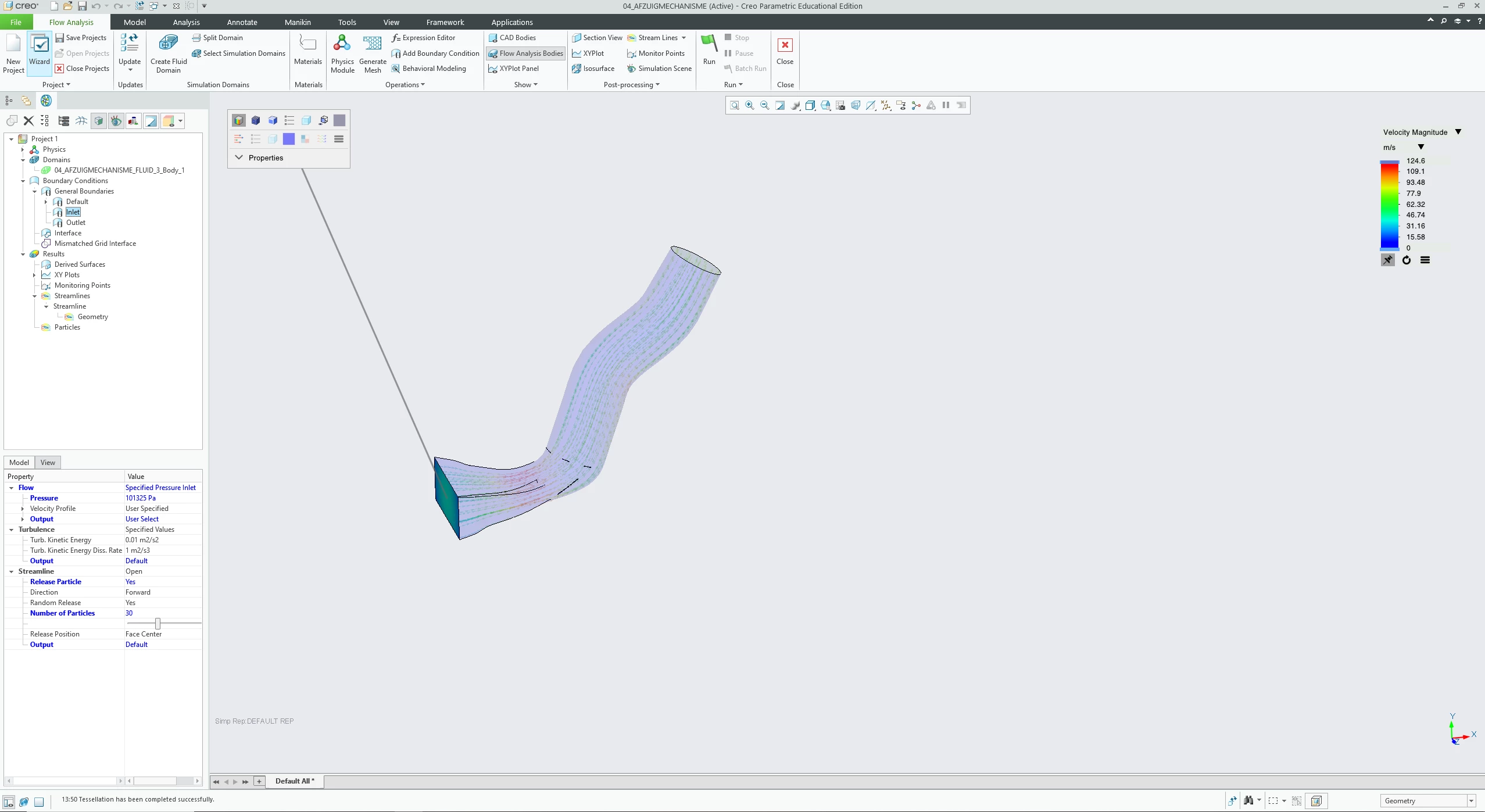

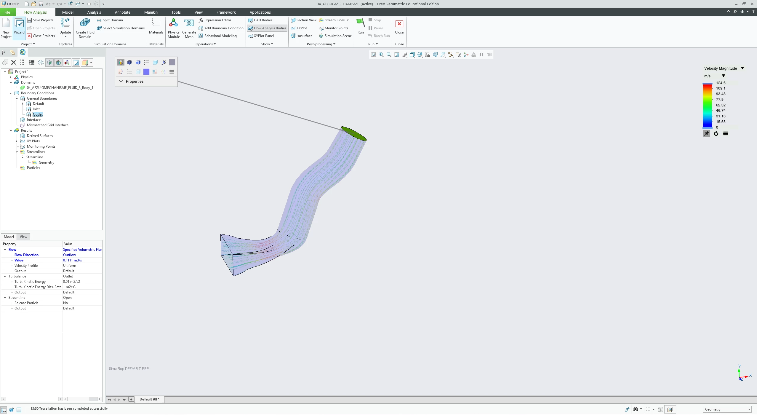

    • Inlet (nozzle entry): Set as 101325 Pa (atmospheric pressure).
    • Outlet (nozzle exit, connected to the vacuum system): Defined as Volumetric Flux 400 m³/h (0.111 m³/s).
    • This setup runs without issues.

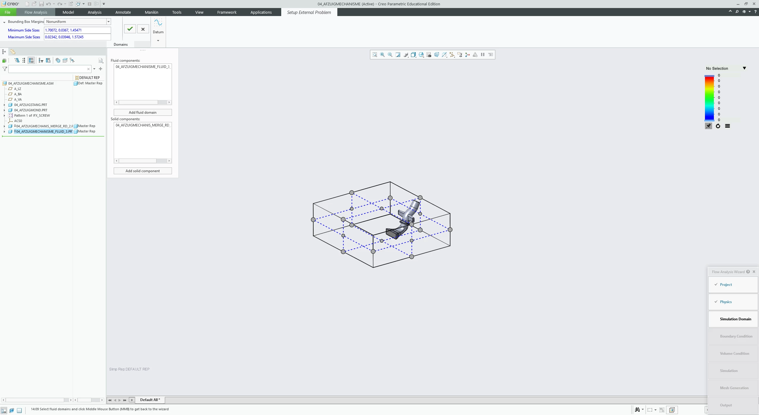

What I am trying to add:
  • I want to simulate how air is being drawn from the surroundings into the nozzle.
  • To do this, I added a large surrounding box to represent the air environment.
  • The walls of the box are defined as inlet and outlet pressures (atmospheric pressure, 101325 Pa).

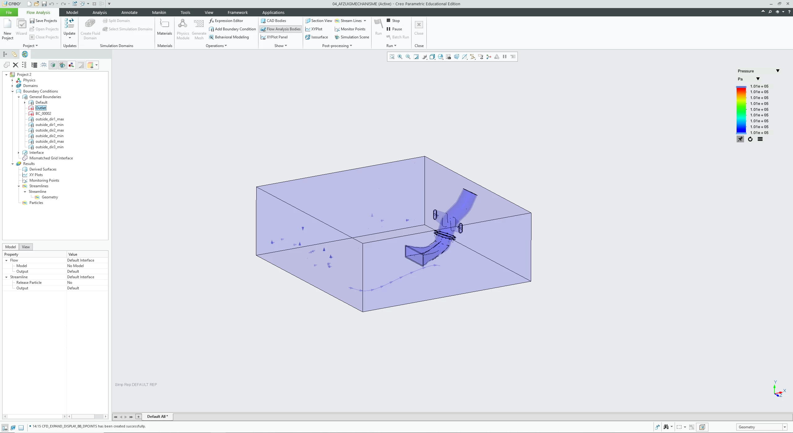

The issue:
  • When I include the ambient air domain, I get errors on the inlet and outlet boundaries of the nozzle.
  • It seems like Creo does not handle both the internal flow and external airflow together properly.
  • My goal is to see where the nozzle pulls air from and how strong the airflow is in different directions.
Has anyone successfully set up a vacuum suction simulation with an external air domain in Creo Flow Analysis? Any advice on the correct boundary conditions or setup would be greatly appreciated! I've also added images for clarification.

Since my last message, I’ve updated the model to include a second internal nozzle. Here's the current setup:
  • On the left, a gas nozzle connected to an argon cylinder (internal domain 1);
  • On the right, a suction nozzle connected to a vacuum source (pulling 400 m³/h, internal domain 2);
  • A small interface domain was added between the nozzles and the surrounding air, as you suggested.
Unfortunately, I'm still running into issues:
  1. I continue to get boundary condition errors at both internal domains inlet and outlet;
  2. The simulation appears to ignore the internal domains entirely—it only processes flow within the interface and the external box;
  3. The physical behavior I aim to simulate is not being captured: the suction nozzle should draw in both the argon from the gas nozzle and ambient air from the surroundings (e.g., also from above or the sides), but the current setup does not allow for this (only in front of the inlet).

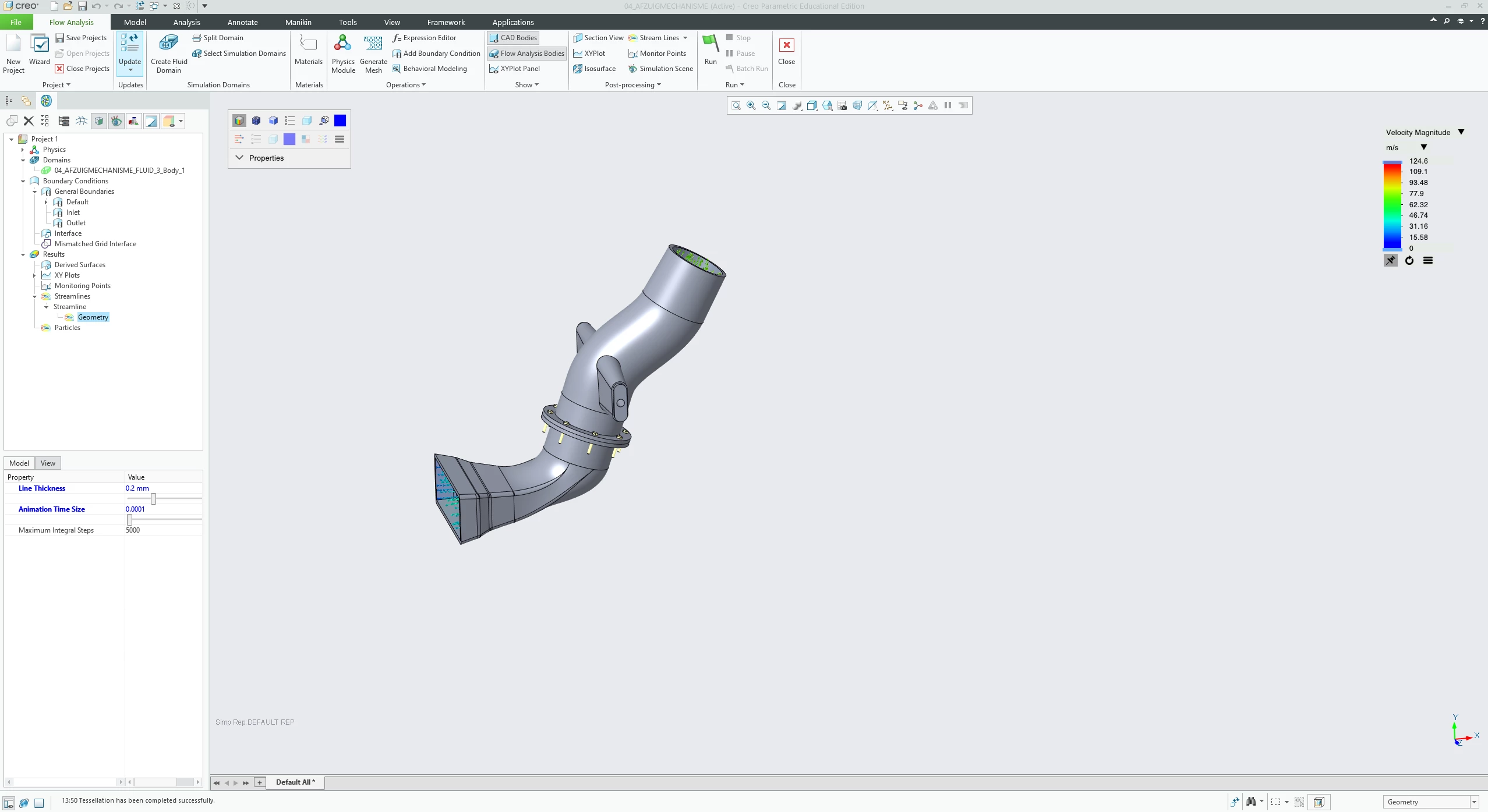

Apr 9, 2025 12:49 PM UTC
I see that the first two domains and some of your boundary conditions are highlighted in red. This makes me wonder if your mesh is good and if your boundary conditions lost their reference surfaces. What are your settings for mesh size?
