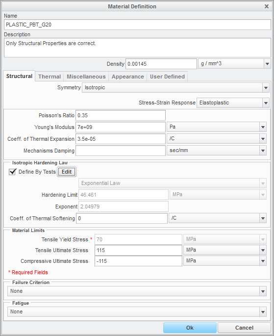

I have been using Creo Simulate 2.0 for a few months for linear static structural analysis of plastic parts.
Now I want to move on to non-linear analysis.
I am facing difficulties in understanding how Creo Simulate sets the non-linear material properties.
The plastic I am using is brittle in nature.
Following are the engineering values available from the vendor's material data sheet:

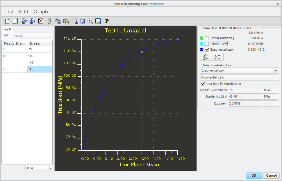

Young's Modulus = 7GPa
Stress at break = 115MPa
Strain at break = 2.6%
Flexural strength = 176MPa (Where do I put this value?)
Yield Strength is not available. So assuming = 70MPa
Here is what I put in Creo Simulate:

The strain values I had entered (see graph in question) were in %. Simulate expects these in absolute terms. This solved the problem.

1. Whatever I have done, is that right?
See here and here.
2. How do I see the entire stress strain curve for the material?
You see only the part of true stress-strain curve after the linear behavior.

5. Does Simulate use the Yield Strength value for any type of simulation? In the sense that if I take the Yield strength value much lower than it is but maintain the same stress-strain curve, will it affect the results anyhow?
That value that you insert in the material tab serves only if you select a failure method, so the program can tell you if the component is broken or not and where.
