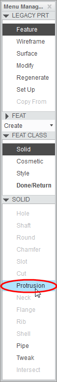

Just thought I should in out of the blue on an ancient thread ... and post a solution to this problem.
I really do keep this crap in my head for years searching for solutions to nagging issues and this one always bugged me.
To Use the "Add Inn Faces" option in Creo 1 or 2... go old school by using this technique:
  1. Prepare curves, sketches, or any other geometry/datums required for your sweep
  2. In the Command Search, type Legacy and select "Legacy" from the "Commands Not In The Ribbon" list (see below)
3. Select Feature->Create->Protrusion->Sweep then select (or create) your trajectory.
4. Select Done. Immediately, the Attributes window will appear... the Add Inn Fcs command is available from this menu (see below). From here, complete your sweep normally.
5. Exit back to Standard mode by selecting Applications->Standard. This will disengage Legacy mode and put you back to the familiar Creo 2.0 menus.
Also... if you're missing your old Wildfire Era menus... Legacy mode is good for that, too. While I wouldn't advocate working there all day, sometimes old commands that have gone missing from the ribbon can be found lurking there- ready for use!
Thanks...
-Brian
