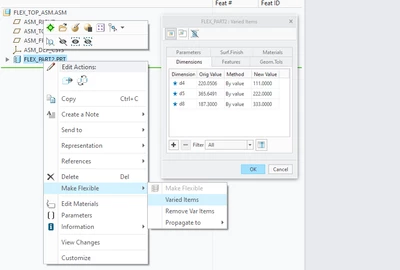

Hi folks,
Please look at simple assembly flex_top_asm.asm. It contains one component flex_part2.prt.
In part thre are defined:
a) 3 dimensions as flexible (open file in new window, then File >  Prepare > Model Properties > Flexible > Dimensions);
b) 3 parameters as flexible (open file in new window, then File >  Prepare > Model Properties > Flexible > Parameters);
Based on PTC sample I've modified method, that should be started on asm level. As a result, component flex_part2.prt will be changed into flexible one, and in Varied Items table dimensions will be shown.
Question is:
How to do it with parameters. How to add them to Varied Items table??
Sample code:.

Create instruction AssemblyItemInstructions_Create.
As a type use ModelItemType._ModelItemType_null.
For Parameter you need specify a name AssemblyItemInstructions.SetItemName. Maybe in AssemblyItemInstructions_Create for ItemId you can pass 0 (zero) in case of a parameters.
Gucio16-PearlAuthor
hi  ysinitsyn,
could you look at it?? There is still  issue 😞
Not sure what this mean.
From the documentation
The value of this argument is ignored for
parameter. For parameter, pass this value as _ModelItemType_null.
static final int _ModelItemType_null - Enum null value.
 Try to use
null
as the argument.
