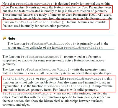

For free Java you can try this:
1. List all features.
2. GetIsVisible ()
3. Check a feature type (for example, to exclude not solid surfaces)
4. List sub items for the feature ListSubItems()

ProGeomitemIsInactive(...) will filter out inactive edges.
Jan 25, 2022 4:32 AM UTC
But, IsInactive() method belongs to FeatureStatus object, which is in paid version of jlink, so you will have to do some workaround
