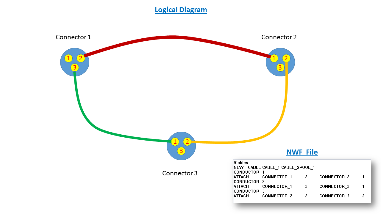

  • If you're using a cable, those conductors will be bundled together as a single entity. The way your NWF reads though... each of the three conductors goes to a different connector. I've created a logical diagram of what's occuring in your NWF. See below (click for a larger image). My point here is that you wouldn't use a cable for this type of connection. You'd only want to use a cable for instances where it makes sense to have multiple conductors bundled together. In this case, it doesn't appear to (unless I am misunderstanding your application).

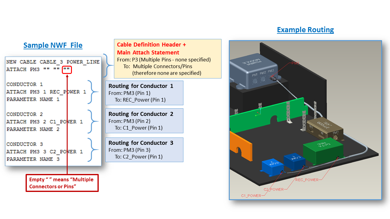

The second issue is more of a formatting issue with the NWF file itself. The link you provided to the PTC.com article is correct. You can autoroute from a cable definition. But I think you're missing a bit of data that's required. I think you are missing the data in the light orange box (with the red text - in the image below). Also, you do not need the Parameter Name data, but you may add it if you wish. Click the image below for a larger version.
I think if you correct the logic error and change the NWF file to incorporate that "Main Attach Statement", your cable will autoroute. Note in the example above, the only common connection that could be specified in my Main Attach Statement was the From connector "P3". On the From side, the cable attached to multiple pins so none could be specified. An empty "" was included to denote that none could be specified on the From side. On the To side, neither a common connector nor pin could be specified. This is why there are two more empty "" sets.
Still, for a cable to make sense... there has to be one common denominator. In this case, the connector P3 was a common starting point. Without this, I don't think you can get the cable to route the way you wish. I could be wrong though.
I'd start by adding a Main Attach Statement to your NWF as shown above and per the example in the PTC.com article. For your current NWF, I guess you'd use four "" empty statements because there's no connector common to all conductor attachments. I don't think this will work, but it's worth a try. Next, I'd try making all of the cables originate from one connector and have it branch to the other two. I believe this will get your cable routing properly.
