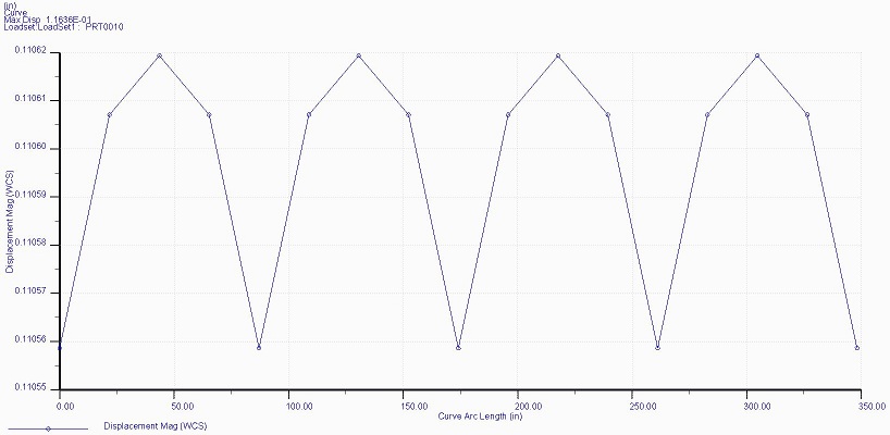

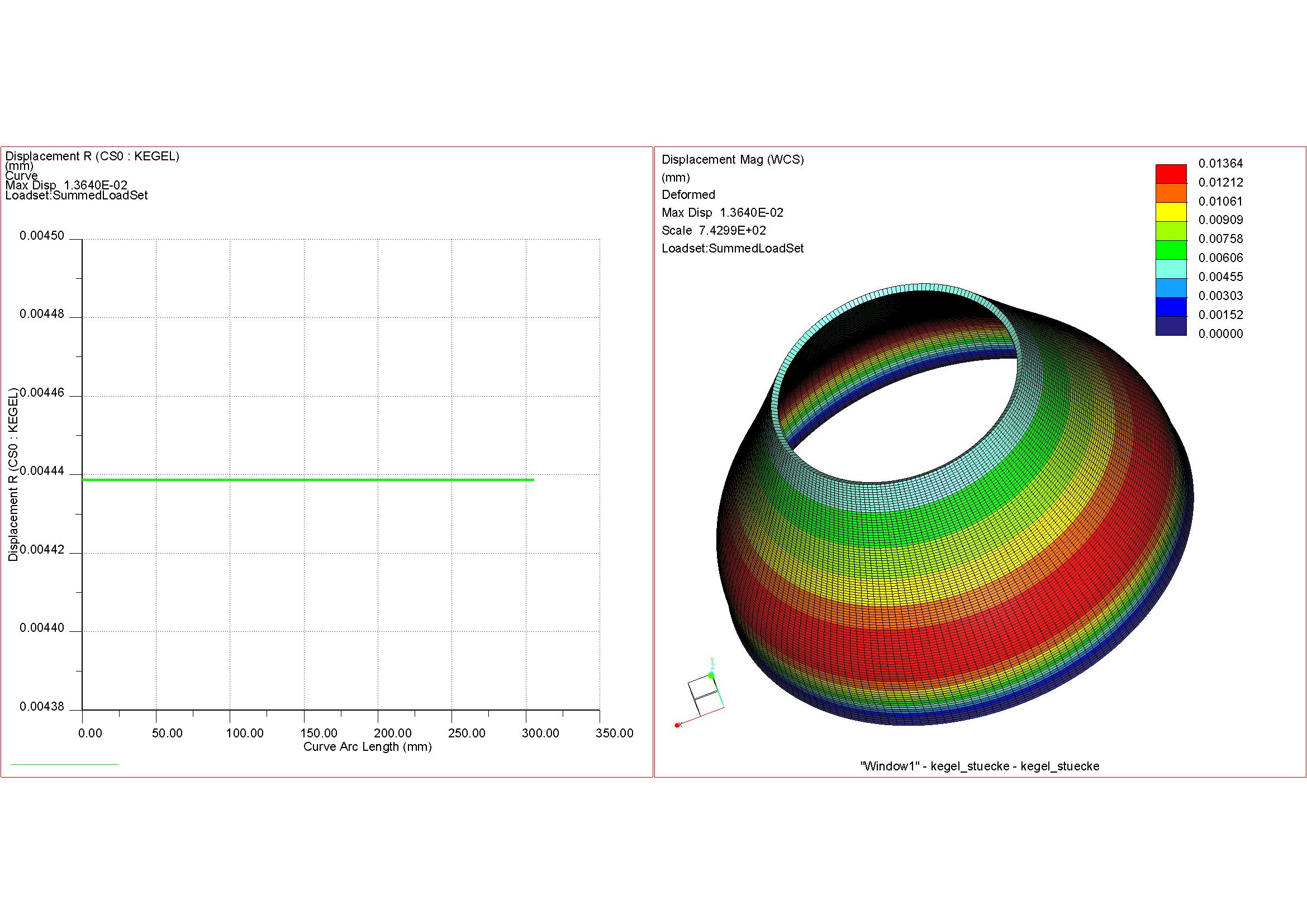

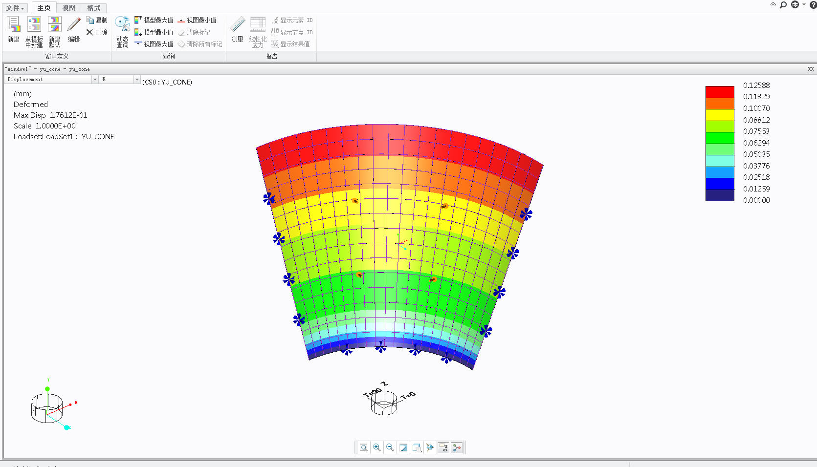

Non-symmetric results for symmetric model and load?
Why is it that displacement for a cone is not rotational symmetric for an internal pressure?
A sample model is attached (Creo 3.0) I've brought it back to the bare minimum. 1/4 cone, symmetry, default mesh etc.
It doesn't help if you refine to enormous amounts of elements, Large deformationm analysis makes it slightly better, but it is never right?
Why is that? it should not happen.
How do we solve this?
Extra: I've added a full 360 degree version in Creo2.0 format

Hi Eric,

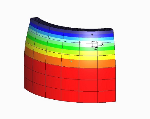

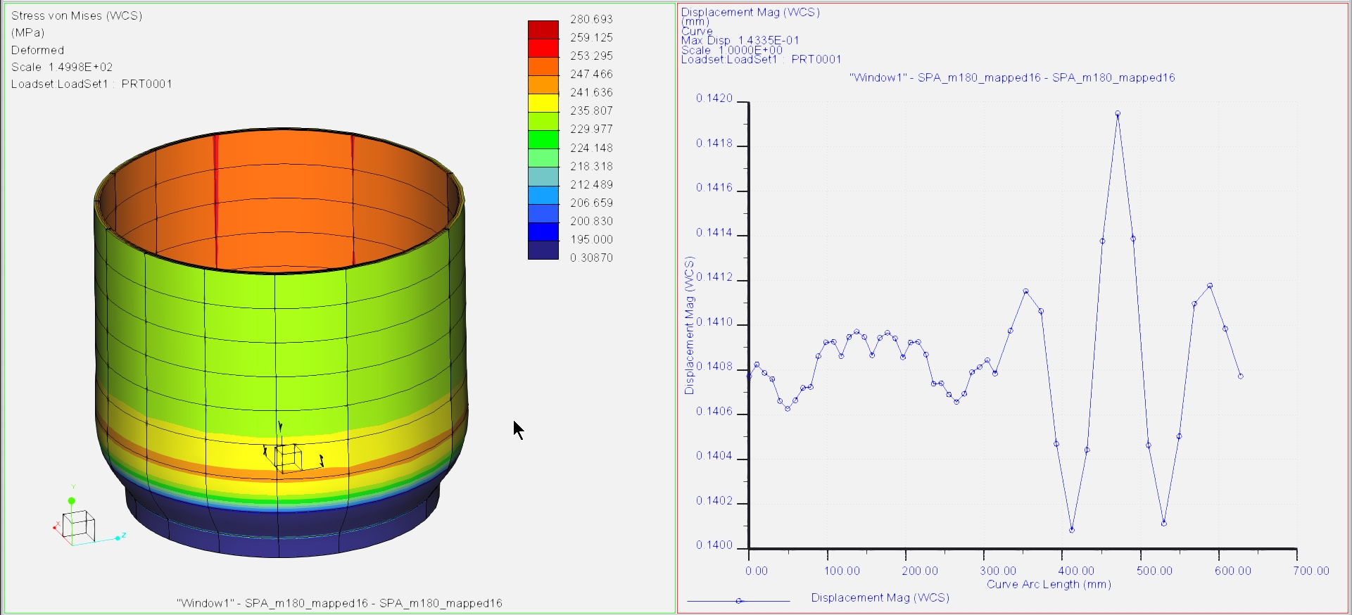

I tested Creo 2 m180 and am very happy with the results; The strange effect halfway the cylinder is gone!
Yes, there is still deviation but it is smaller then the convergence criteria (2% in my case), even with default mesh settings.
With mapped mesh, you can do the same with much less elements, but you do see some deviation over each element. However, this deviation is also smaller then the convergence set. Following example has one half divided into 4 and the other divided into 8 elements. It seems you can control the result much better now with increasing element numbers;
BUT, we saw before that one example can look fine, while another shape shows much bigger deviation, so it would be great if somebody else could confirm this.

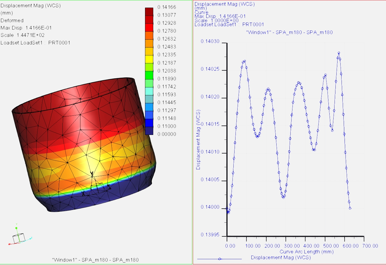

geometry transfer from parametric to simulate is inaccurate:
30°, 60°, 90°, 120° etc.error expand
As assembly 180x2°:

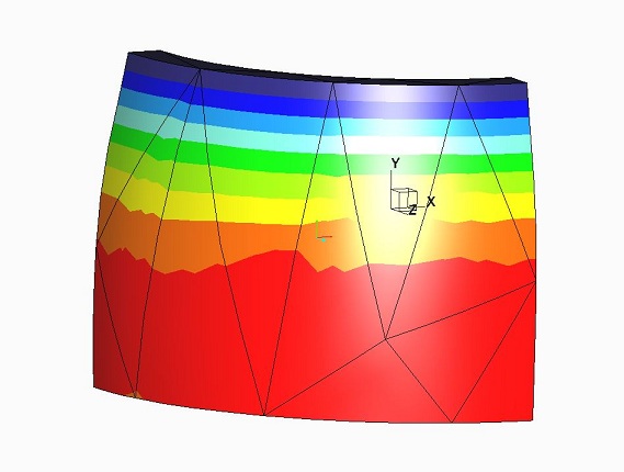

In Creo Simulate, based on the component (solid or surface geometry) AutoGEM tries to create tetrahedral elements where applicable.  This is the default behavior.  Here is an image of the default mesh created in Simulate for the cone model provided.  There are 234 tetra elements created.
Now running the analysis, you will find the results do not match the expected max displacement of 2.367 mm as in the thread above (Abacus results).  Obviously, there is a discrepancy in the analysis.
An area we have been investigating was the defined size of the elements shown in the image above for this model.  Now Simulate does process the size of the elements based on a number of factors during AutoGEM - model size, size of thin walls, etc. The element size optimization helps provide accuracy in the results versus compute time needed to run the analysis.  In most cases, the element size optimization output is appropriate and helps provide accurate results.  However, in this example, due to the thin wall, we feel the size of the elements might need to be reduced beyond the optimized size produced from AutoGEM.  Development is investigating the algorithm and seeing if it can be tweaked to see how this will improve the results.....at the same time, not causing ill effects elsewhere.  By ill effects, I mean lengthening the process time for all analyses as a result of increased number of elements created by AutoGEM.  Note: this tweak would be a global setting, so we need to be cautious not to negatively impact Simulate. We will have more news on this upon completing our investigation.
Now for this model, we can show that reducing the element size can provide results closer to the expected max displacement.  To try this, you can add a Mesh Control Option - Max Element Size.  In my image below, I changed the max to 12 mm.  This will obviously increase the number of elements created.
Running the analysis, the results are very closer to the expected max displacement.....off by ~1%.  This assumes the results shown above from Abacus were correct.
Another approach would be to add other mesh control options, such as Thin Solids.  This will create both brick and wedge elements.
Again the results are very close within 1% of the Abacus results.
In both these cases, the user would need to add the control options - thin solid or max element size.  To help influence the analysis without the need to add the options is the reason why we are investigating a tweak to the optimization algorithm for element size.

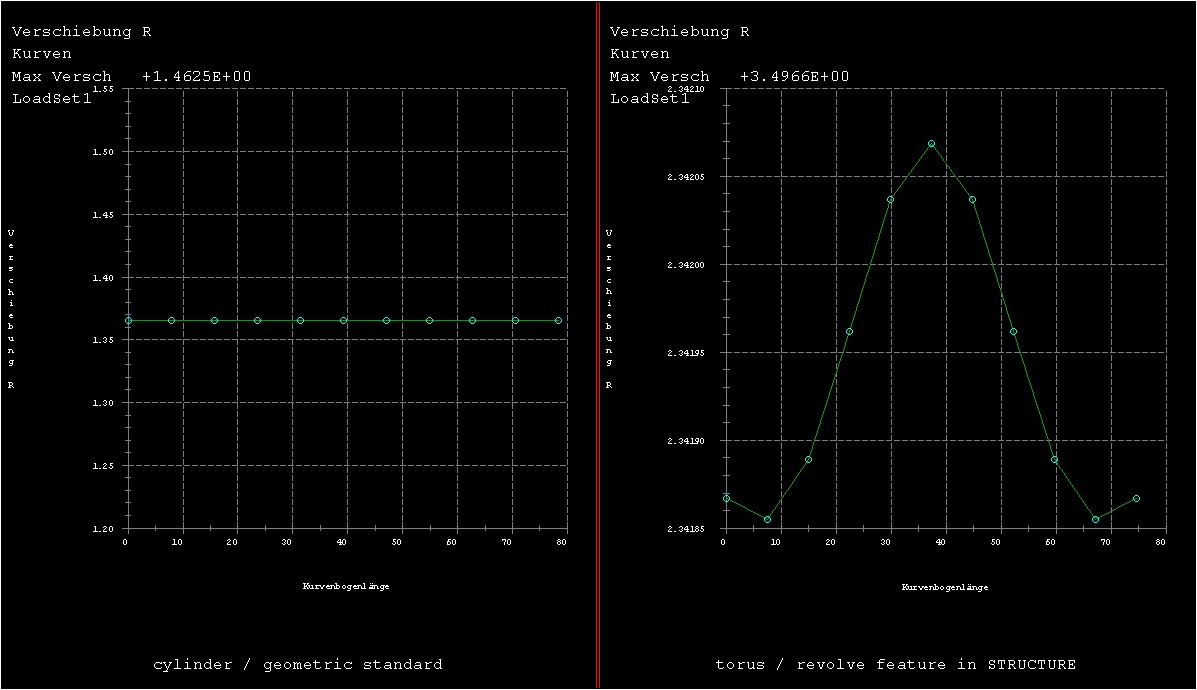

revolve feature in STRUCTURE is inaccurate:
this "ERROR" is 30 years old.
Paul
September 2, 2016

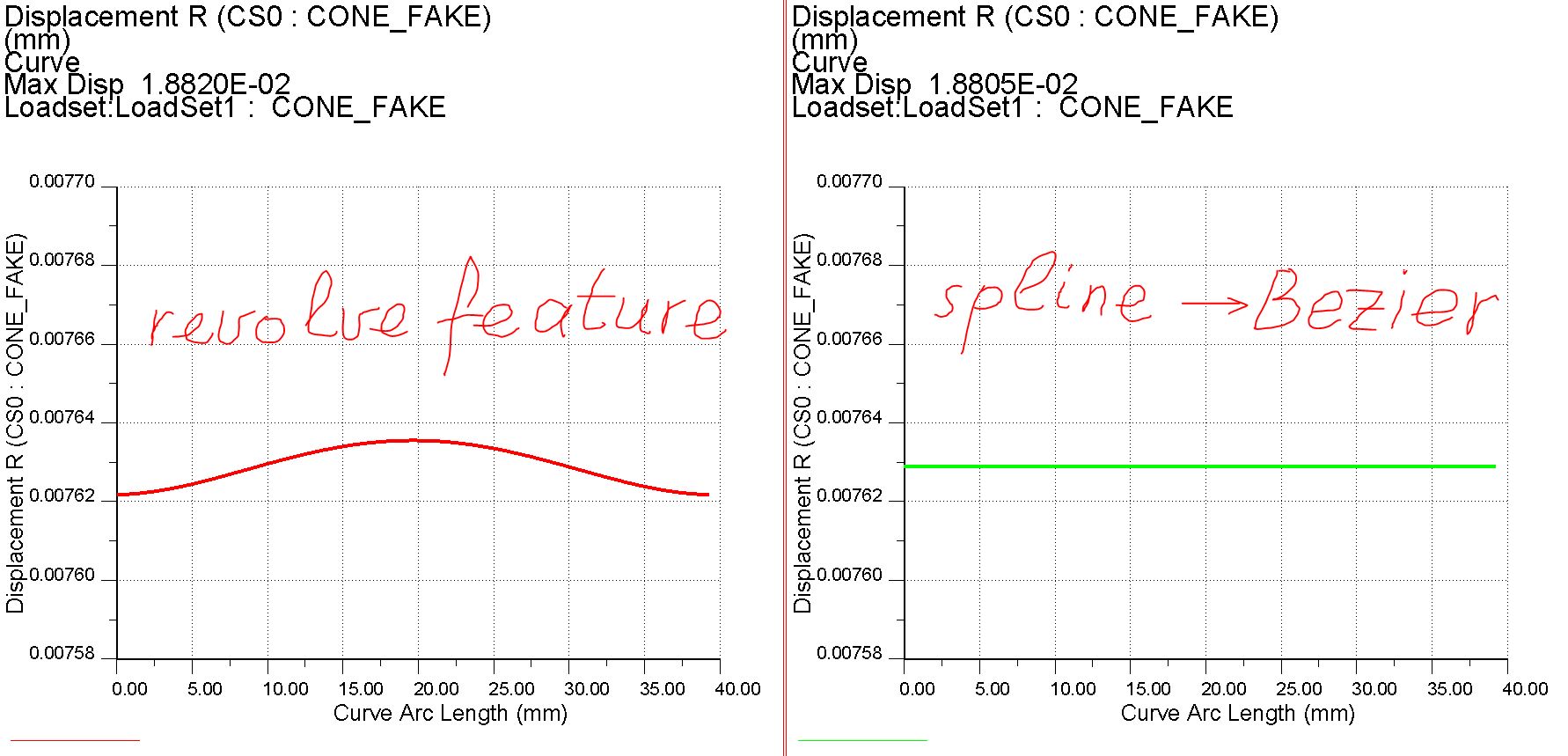

workaround:
fake of geometry to bezier.
example attached
Regards
Paul
September 9, 2016
comparison bezier vs. revolve
(Creo Simulate 2.0 M080)

Prefer Swept type mesh for rotational and cylindrical objects. Formation of element and nodes plays crucial role in analysis.
September 11, 2016
"Formation of element and nodes plays crucial role in analysis"
yes, exactly
"Prefer Swept type mesh for rotational and cylindrical objects"
well, that is the problem
revolve of spline geometry only is correct: as bezier surface
September 12, 2016
yes, exactly
Well, yes and no...
To play devil's advocate a little, 1) Simulate (Mechanica) is supposed to remove the need for the user to 'worry' about the mesh so much; and 2) surely for a simple analysis such as this, with very smooth stress and displacement contours, even a very 'poor' mesh should give the correct result?  Particularly when looking only at displacement, for which a coarser mesh is traditionally considered adequate.

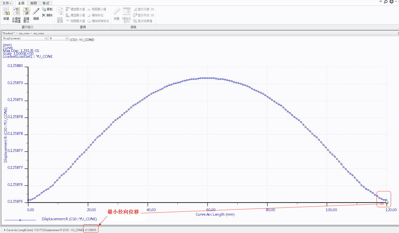

November 24, 2016

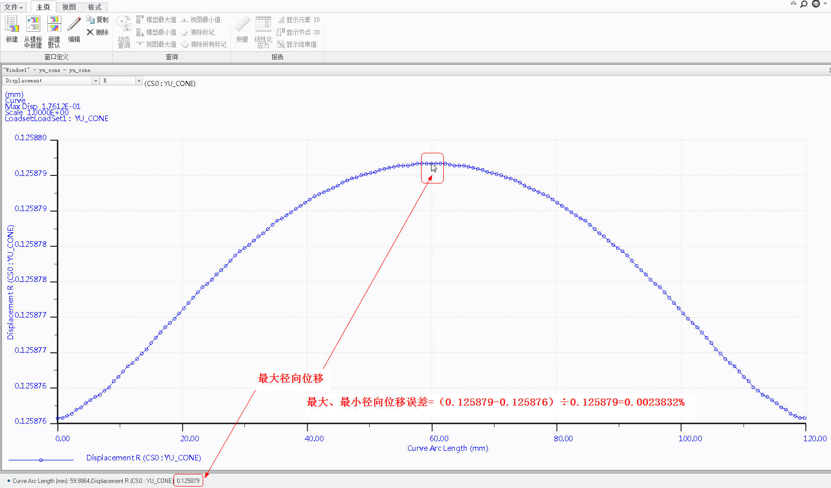

It's difficult to attach the result files,so sorry! Remember to use cylinder coordinate when you check the displacement !!!

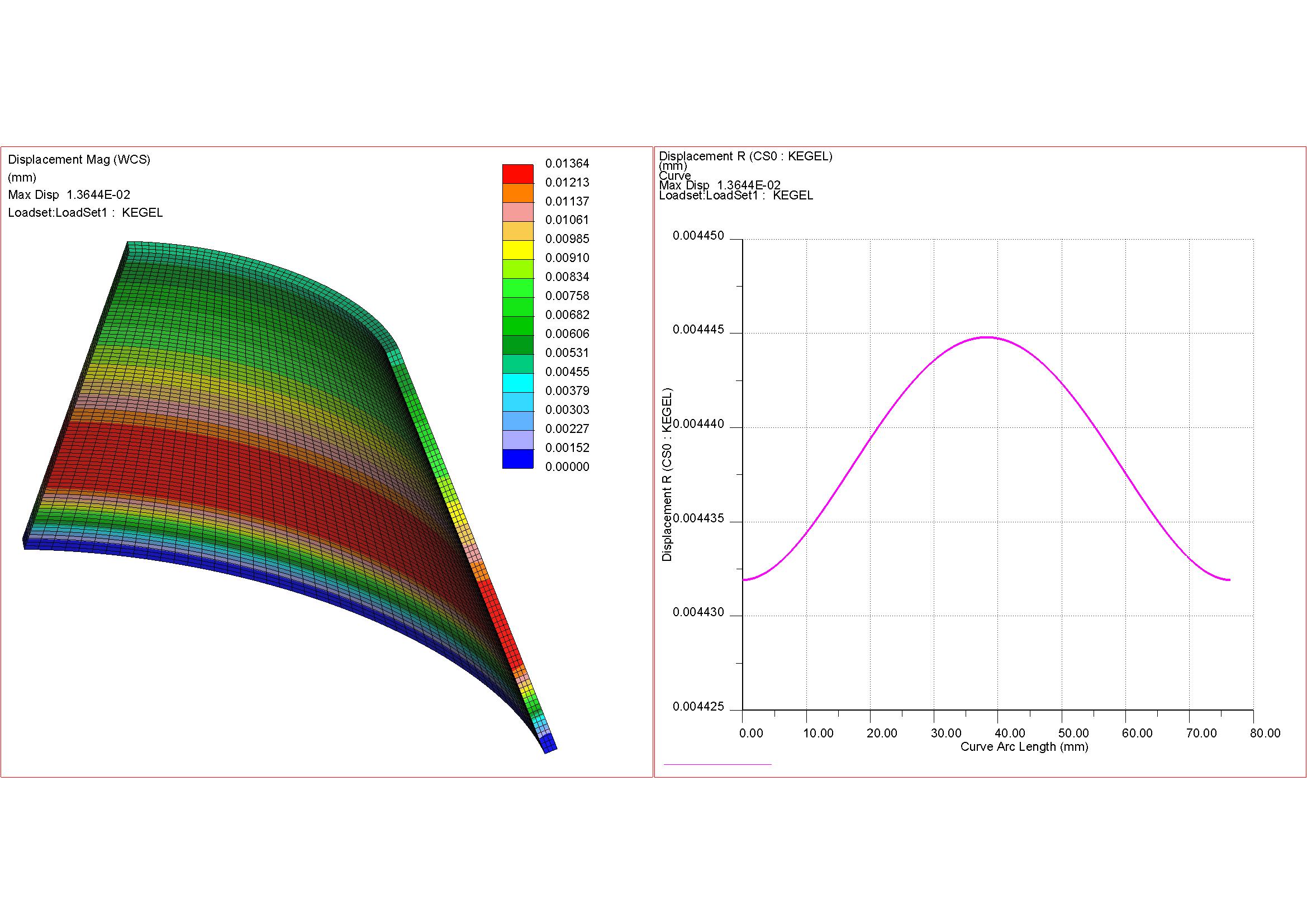

bezier has exaktly 0%
example (bezier vs. revolve).

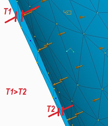

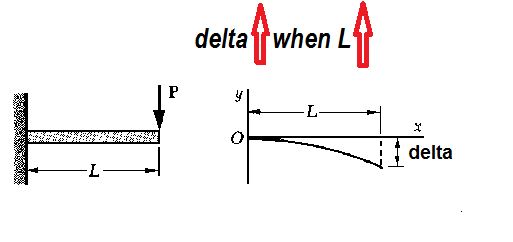

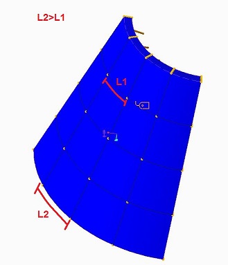

It seems as though the stiffness of elements is not being held constant during calculations.
If we take a simple example of a beam with constant area, its stiffness is AE/L, so stiffness is inversely related to length . As L goes up , stiffness goes down, so nodal displacements should increase. Also, we have applied pressure load, which should transform to perpendicular point load (P) at a beam end like this.(the beam becomes element edge) Delta should reflect the deformation.
In our cone model, even brick elements produce unequal edges, which are longer at center and shorter at ends.
I tried the model in first reply(by Matts) which produced good results initially but deviated once the thickness became variable, so element area seems to affect the calculations as well. Maybe thats why it was suggested to use thin solids.

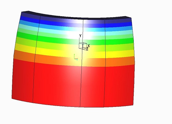

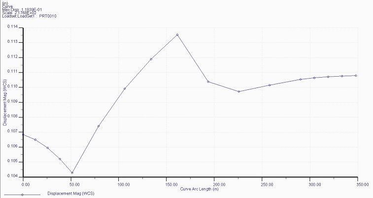

Lastly I tried the above scenario with a quarter cylinder using a similar setup.
Again, the tetras(default) create unacceptable output. Both prismatic elements and brick elements produced clean results possibly because element edge lengths are uniform.
However, tetra output quality gets better as mesh gets finer.
Displacement graphs in tetra shows a very high variation(crest-trough) while the brick shows little change.
Tetra has a global peak at the center, which is not observed in bricks model. Also, the brick model is kind of repetition of a pattern which appears to depend on the no. of subdivisions.
Just a hunch but if this is the case, the software should do some sort of "internal normalizing" before publishing the results. Inputs are welcome.
