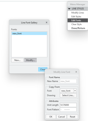

Refer uploaded image - I want to change the line style of CTRLFONT_S_L, L_L, S_S, PHANTOM_S_S.
All these lines are appearing change in the model. so i want to modify the line length so that i can differentiate the lines in my diagram for different pipe sizes/colors.
Basically i need additional line styles to differentiate all my pipes/tubes in the plumbing diagram.

You can create new style only while in drawing 😞
But you can create all the lines in 3D and then just change them to correct pattern in drawing aka. 3D solid line -> 2D dashfont
