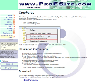

This tool worked very well for me:
http://www.proesite.com/newframe.htm?/UTIL/creopurge.htm
