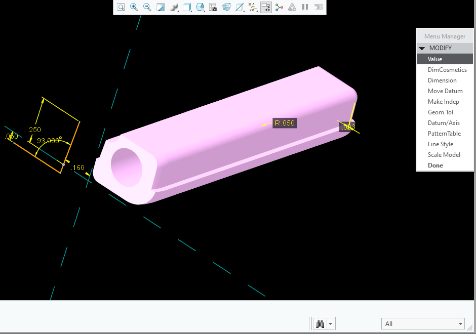

Here's an example in part mode.  You can see dims for a curve, a round, and an offset all on the screen at once!  Just click the dim you want and the box pops up to enter a value.

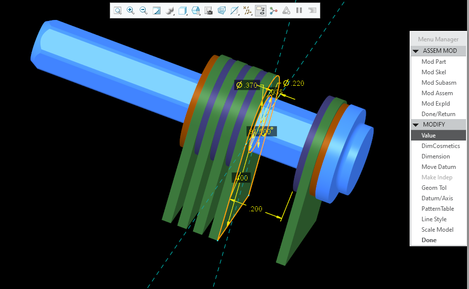

Here's an example with an assembly.  Works exactly the same as described above.  In this case it's showing dims of 3 different parts all at once.  Notice that the assembly version of the Menu is a little different.
Here's the same assembly after a modification.  You can see the feature dims AND the part dims (0.200) at the same time, with one click.  No hover time, no selecting multiple things in the model tree, no setting filters so you can get both parts and features.  This is SSSSOOOOOOO much faster - and it's consistent for both parts, and assemblies.

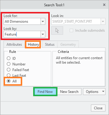

try Search Tool
Martin Hanák
@MartinHanak Thank you for showing this.  It does show dims from multiple features.  Could not see how to choose only specific features in multiple models (unless they all happen to have the same feature number 🙂 .  Also, I don't see how to interact with the dims once they appear.  Can't modify a value, for instance.  The dims continue to show even when the tool is closed, but I can't interact with them.  I can see that this tool is valuable in some situations, so again, thank you for showing me.

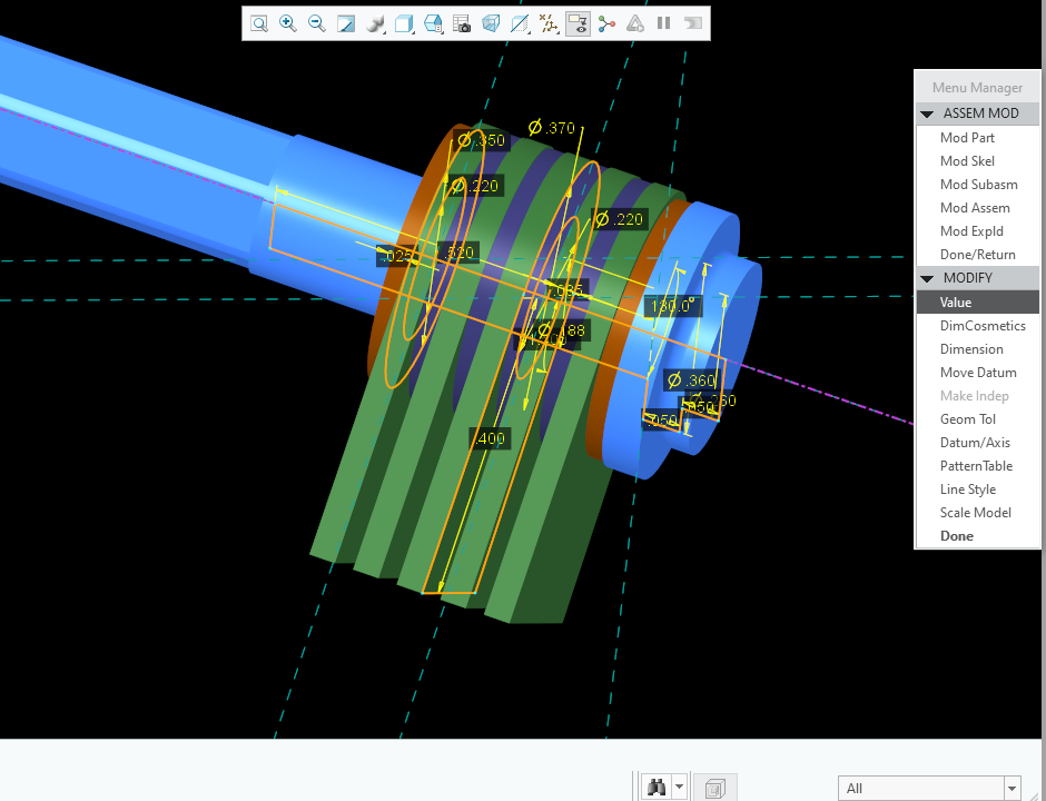

The relation editor function can be used to do this.  To display the dimensions for multiple features from component models in assembly mode see the picture below with an example displaying feature dimensions from two components within an assembly.

@tbraxton  Thank you.  Yes, this also works to see dims from multiple features.  And, you can select only specific features in multiple models.  But, with limited interaction.  For fun, I picked dims, then assigned them a value in a relation, then regenerated, then went back in and deleted the relations.  It does work, but that's a terribly arduous workflow.
