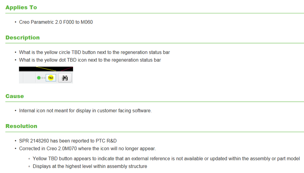

please find attached snap. At the bottom corner an error is displyed (highlighted in red box). No error description is visible on status bar.

See:
https://community.ptc.com/t5/Creo-Modeling-Questions/TBD-next-to-green-light/m-p/255578#372552
https://www.ptc.com/en/support/article?n=CS81624

Check article CS31615 about this.
CS31615
configuration option enable_implied_joints as no

This article reolves my query. Thanks

It means "Disconnected" and it will appear where there is some problem with the mechanism constraints.
