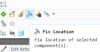

There should be the "Fix Location" command in the right-click menu.  Note it is only available if ALL the selected components are unconstrained.

It's already assembled with some other reference. I want to remove that reference and give fix constraint. Is that possible?
