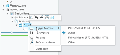

Add the bulk item to an assembly, expand it out until you see the body of the bulk item, right click on the body and Assign Material.
Edit:  Just realized you said Creo 2.0.  Not sure if this would be supported.
