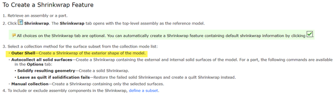

We have a process to automate shrink-wrap creation for customers.   Seems that you can either turn fill holes on our off.  Would be ideal to fill internal features to remove IP but keep external features like mounting holes.  Does anyone have any ideas on how to do this?

I'm pretty sure what you're asking for is available in Creo 5.0. If you are running an earlier version, I would suggest using simplified reps to simplify the model before shrinkwrapping.
PTC Documentation
Ty
August 6, 2020
We have Creo 4 in production, but I've also tried in Creo 7 and doesn't seem to have changed.  FYI I used the save a copy version.  What you are showing is the option to create a feature within the assembly.  I have tried that also but not had any luck.
