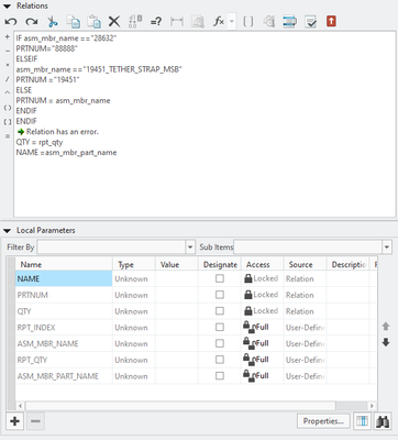

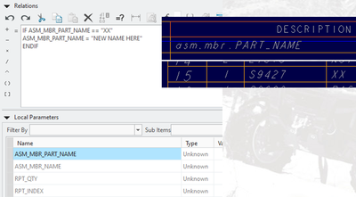

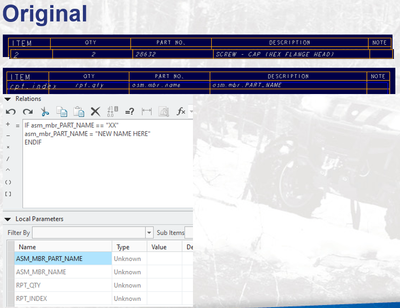

Hello, I would like to to override a few items in a BOM table and keep all the items programed.
I have the following code entered but its not working,
I would like "XX" to be renamed to the actual part name "HEX BOLT"
Are there any specific settings I need to review?
Does the type need to be defined, if so where do I do that?
The view contains an assembly with a simplified rep.
I'm using Creo 7.0

is there a syntax guide?
elseif is not implemented.
Use following code
if asm_mbr_name == "28632"
   PRTNUM="88888"
else
  if asm_mbr_name == "19451_TETHER_STRAP_MSB"
    PRTNUM="19541"
  else
   PRTNUM=asm_mbr_name
  endif
endif

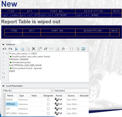

RL_4555254
(To:kdirth)
Thank you for the response,
I still seem to be missing something.
I left the index alone.
The BOM is not populating after changing the parameter name, and relations won't recognize the old parameter name now.
I ensured the model/rep was selected and updated tables.

please replay uploaded video. It will help you to solve your problems.
Martin Hanák
Thank you!
That helps. I did not know I needed to add the original parameters
I can now get everything to load.
key point is defining the other items as well.
The if statements will work by themselves, but I cannot get multiple to work.
the syntax seams very specific with spaces and "
right now it won't accept the second endif.
it would not accept Elseif with a space "Else if"
