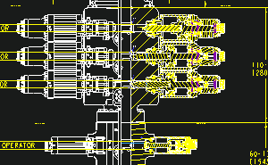

Creo 8:  Well, ain't this peachy.  Got a large assembly in a couple different configurations/Reps (some parts not used in certain Reps), and if you create the dwg view using a Rep, but then change the Rep at the assy level, the BOM will change but the dwg view WILL NOT.  Replacing the Rep for that view, or everything else I tried, DO NOT WORK.  The only thing that worked was DELETING the view, and putting a new General view in it's place. Nice, especially since it's a large assy with a bunch of sheets.  So, my "Pro/WORKAROUND" is to NOT make dwg views until you are 100% sure the Reps won't change.
Must be all that "Enhanced Functionality" PTC keeps crowing about when they waste time giving us confusing new interfaces, but spend zero time fixing bugs...you know, like that "split cylinder" BUG, or the one where threads don't show up in the model except in wireframe viewing mode, or.......
Anyone else run into this issue?

For some reason, the BOM updates, just not the view.  I added a part to the Rep as a test, and while it would highlight when I hovered over it in the model tree, it flat refuses to show in the view.  I tried everything I could think of (replacing the Rep with the Master Rep, changing to another All state, using another viewing angle, changing the view from shaded to wireframe etc, etc.), nothing worked except deleting it.  And from the posts/articles I found, it's a known (also to PTC) issue.  I'm doing something a little tricky with some of the OTHER parts further up in the model tree, but these ones causing the issue in this particular view are super simple parts I made and put at the bottom of the 'tree just to test what I was seeing.  Also, before I put these 2 parts at the bottom, the parts further up the tree cause the same issue when I added another one of them.
