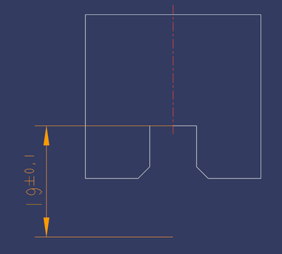

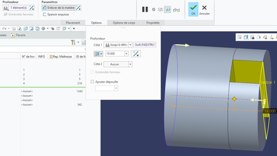

I'm working on Creo Parametric 8.0.4.0, I created a Extrude function with option until reference.
As you can see below, the dimension is reverse.
This problem does not occur 100% of the time, for example if I delete and redo the function, the problem is fixed. Is there a faster way to solve it then recreating the function ?
Thanks in advance.
I am not able to reproduce your problem in new drawing. It looks like your drawing is corrupted somehow. Please contact PTC Support.

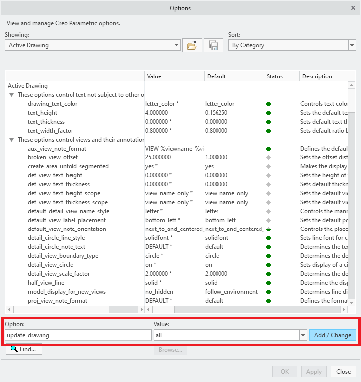

If I apply hidden option update_drawing all in your drawing and update it, the dimension is displayed correctly.

Hi @MartinHanak
Could you please explain the hidden option "update_drawing all"?
What is the purpose of this option and what does it do?
@ProFeature wrote:
Hi @MartinHanak
please go to https://www.ptc.com/en/support/ page and use their Search The Knowledge Base tool. Search for update_drawing all
