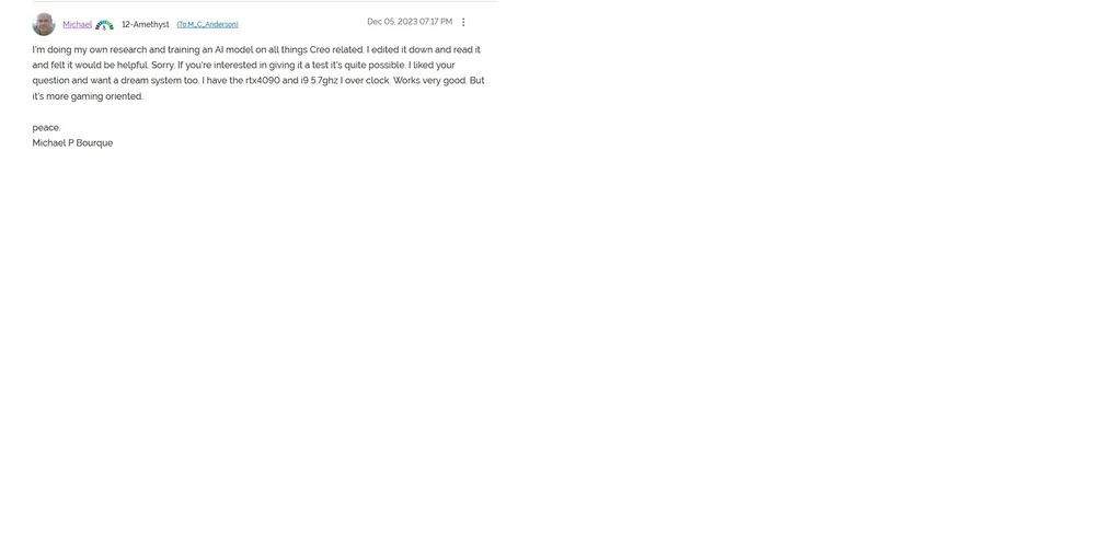

Is this a sneak peek of a ChatGPT assistant for Creo? Maybe add a footnote that the answer was AI generated next time.
Jaime_Lee
Community Manager
(To:kotlownia)
Hi, Kotlownia,
Michael is running his own experiment on an AI tool he has built for Creo independent of PTC.  Best explanation from Michael that I found on a previous post.  I think he is reviewing and editing responses before he posts the content to fit the scenario...not 100% AI generated.  Thank you for your suggestion.
