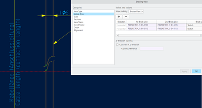

Hi guys,
i have a problém with broken view. When i make in Visible area Tab everything is OK, I can see the break lines but when I click apply and ok and the small window disappears then the break lines disappear too … can’t understand

Difficult to diagnose without a picture or model.
Attach an screenshot of the issue along with a screen shot of the view properties window of the broken view selection.

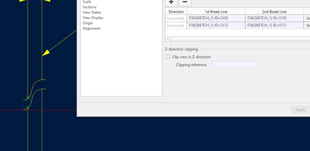

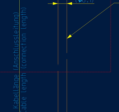

The properties:
View After click OK
StephenW
(To:MB_9236701)
Well, that seems random.

My notes ...
1.] You are breaking geometry in vertical direction, but in dialog box I can see Horizontal option
2.] You selected F36 as breaking line ... I would expect pipe edge
3.] Please upload test data (drawing + part)

Hi MartinHanak,
1. I have tried it in many ways so the picture could be just one variant of my attempts.
2. yes you are correct
3. I can’t upload it
The whole cable set is made in assembly which contains 3 solid bodies as connector plugs and then one part which represents cable harness. And I have noticed that if I do the broken view just on the solid parts it works perfectly. But the harness part doesn’t. Is it even possible to do proper broken view in the part made by cabling mode ?
