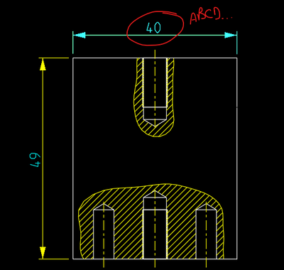

Hi I would to change the value of a quote buìy a text.
How can I do this?
Best regards.

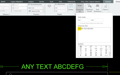

Change @D to @O (letter O) and type the text in you would like to display.

I want to substitute the number with any text.
mkajdan
(To:MB_10508968)
FYI ... @O (letter O) can be used for dimensions created in drawing. You cannot use it for shown model dimensions.
