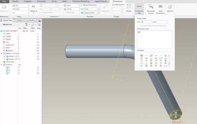

Can't access 'dimension properties' on shown dimensions (Creo4) (dimension text)
what is it the problem with it
StephenW
(To:T_CAV)
The model is locked (non-modifiable).
or
There are no dimension properties in Creo 4. When you select the dimension, the ribbon automagically displays everything that used to be in the "properties" dialog box.
