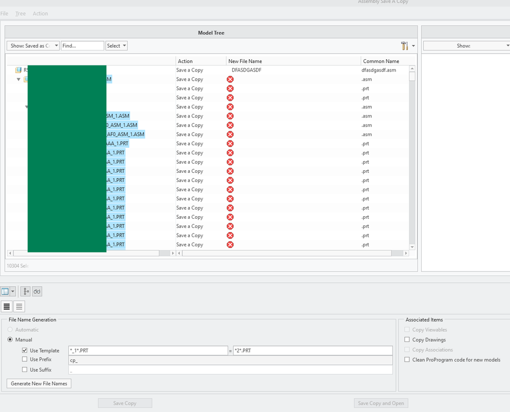

I am using Creo 9.
I have received a large step file with over 1k components, I have imported it successfully and now I need to rename some of the files.
I tried to use "Use template" option - no matter what I choose to do - the generation of file names would wipe out all of the values in the "New File Name" column (see screenshot attached). I tried  asterisk symbol in front, at the end, or both in front and after the characters i need to replace; i also tried using suffixes and not using suffixes for the new file name.
I also tried File > Save, edit file list in excel, and then import it back, but it doesn't apply the renaming when importing.
I see most of the problems with file names being too long, but I can't remove sections of file names using template. For example, i need to replace "STEEL" in the names of the files with "S" in 200 files, but no matter what I do I can't make it work. If i use "Template" then it wipes out all names, or if I Export the file names into txt and then edit them - then it simply doesn't do anything.

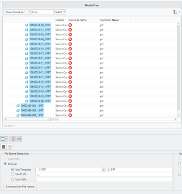

I don't have one I can readily find with long filenames so it's difficult to test and be sure it's right.
My first thought is to get rid of the .PRT
I did that test with it and it gave me an error.
I restarted the save a copy (not just changed the template name and on Second test), no ".PRT* and if worked perfectly.

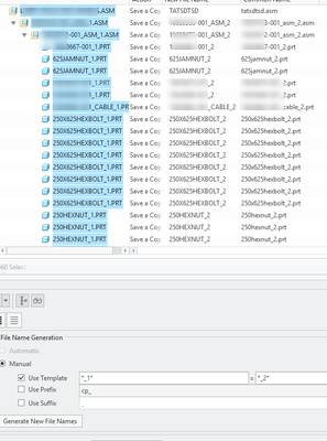

I agree that using the file extension in the renaming template is problematic. I also experienced issues when trying to use the extension.
If you are looking to rename the models, why not use rename.

I managed to sort this out, but not quite. I think what I figured out is that on very large assemblies Creo can't handle the template and the "Use suffix" at the same time properly.
What I ended up doing was using the template on where I can, saving the assy out to a new file, then opening that new assembly (with renamed files according to the template), manually renaming a bunch of files, adding a suffix at places, etc. This required spending quite a few hours, and saving 3 copies of original assembly, but eventually I managed to do it.
It was very tedious, now that I am aware of it I could do it in 1/3 of the time, but this particular aspect seems very weak with Creo.

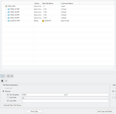

You rename template is not right. Try something like this.
