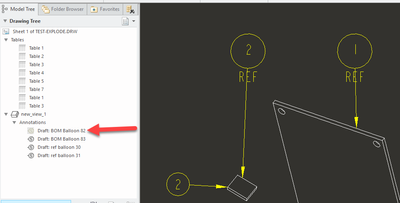

this is my drawing tree fully expanded.
I use a standard license, could this be because of it?
kdirth
(To:Ginu_EL)
Select the "Table" tab and expand the Drawing Tree to see the bom balloons.

Thank you. It worked.
