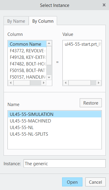

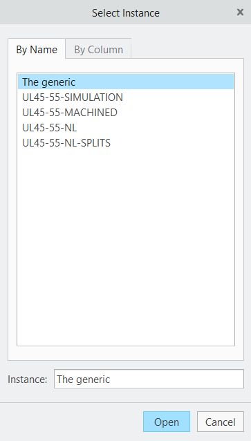

I built a new template model that included 4 variations for machined, non-machined, holes removed and simulation states.
After submitting the template I wanted to cross check it.  When I go to open the template I see that all family table instances are available for picking.
I chose the generic.  I went to family table to check the other instances.  There was no family table in the model that once had a family table.
By any chance is there a way to get the family table to work in a template?
The work around of course is to save the file to a specific location and do a file save as, but the template interface is more streamlined.

I forgot about the road block here that I encountered earlier.
I just put a considerable amount of work into creating a new template file that has a family table.
Today I went in to use the template file and was confused why the family table did not come across.
When importing the template model I can see that every element of my family table is in there.
I see the generic with all of the sub sets.
If I tab over to "by column" I can see that all of the differentiation is accounted for.
It would really seem that you should be able to bring in a template model with it's fully functional family table as everything seems to be there to bring in.
I just want to revisit this topic to see if there might be a way to bring in the complete template model.
Once again; I can save the above needed model file in a specific location but using the template insertion interface is a lot more streamlined.
