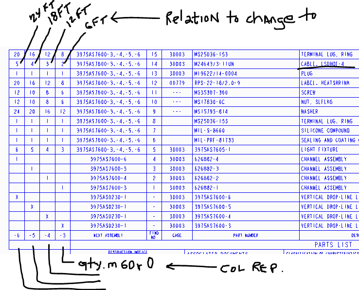

Can I write a relation for above col rep'd bom?
Wayne

do you want to change values for CABLE item, only ?
Which repeat region parameters are displayed on first four columns ?
Martin Hanák
Hi Martin,
Yes - just the cable for now.
In the columns the following were generated by rpt region col rep command:
-3 qty.m60r0
-4 qty.m64r0
-5 qty.m68r0
-6 qty.m2r0

Those values are auto generated when using column rep I believe?

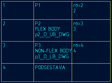

see my example and upload your pictures.

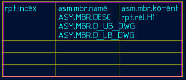

In my test drawing I have following repeat region table placed:
If I activate Table tab and click Switch Symbols command the I can see following repeat region table:

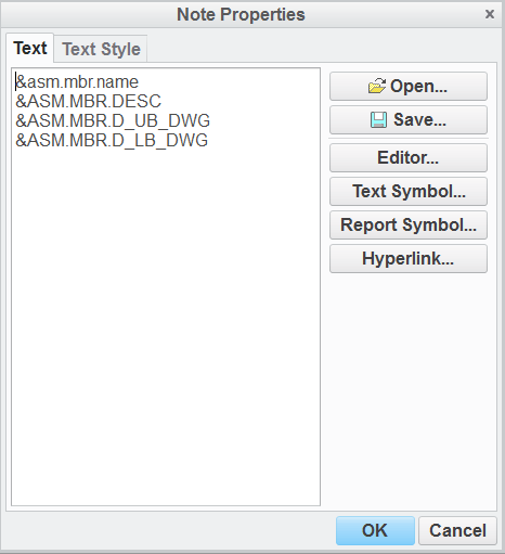

If I select cell in 2nd column, press right mouse button and click Properties command I can see following dialog box:
What information can you see in your drawing ?

Martin,
qty.m60r0 initially is rpt.qty. when I mouse click it it reveals qty.m60r0. I don't get it either. Has something to do with the "column rep" initiation.
here is a .tbl and a .cvs.
Not sure if .tbl is any good without everything???
On a side note....I am using 2 boms. This one to break down different assembly configurations and another to show balloons. its such a cludge. But due to the inability for creo to show baloons in the colum rep version of the bome...this is what we all use as a work around.
I can only hope there is a better or 'right" way.

I am sending you my test data. Open drw0001.drw and investigate table and its repeat region.
Martin Hanák

Yes, quantity columns belong to simplified reps and I used Repeat Region Column Rep  command.
