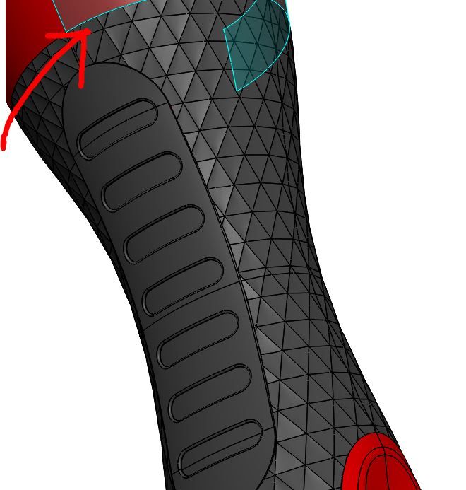

I made it with unique texture/pattern on TPR area. Creo - especially with ISDX - does the job regarding surfacing very well. Problem occurs while modeling pattern like this:
I tried  accomplish this texture/pattern design in Creo not in Rhino, Alias or as rendering with normal map in Keyshot for example.
Finaly I did it, with quite a success, I think.
  I made it possible with advantage of Flatten Quilt Deformation tool. It looks nice, however there are some issues I still do not clearly understand.
It seems the final surface it twisted/rotated a little bit (check a picture below for more info), and "items" of deformed flatten quilt are "extended" on the ends of surface
Any help will be appreciated.
