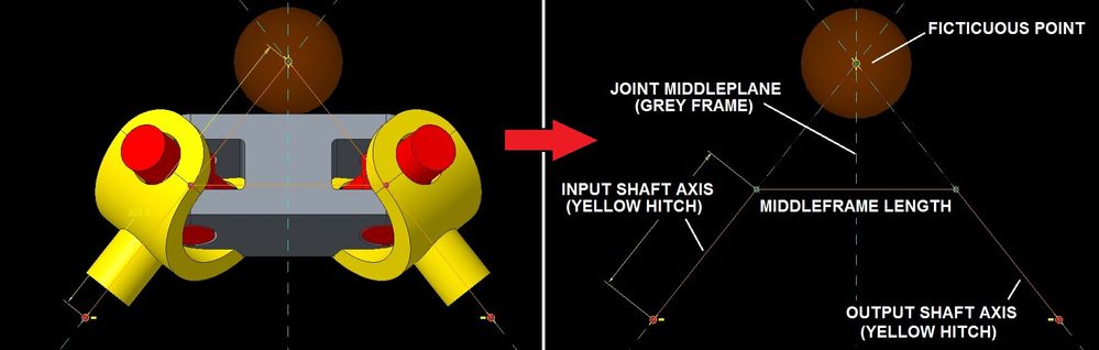

The model I want to create can be simplified considering it as two joints in a row, but imposing some constrains to their angles.
As you can see in the pictures below, turning angles of red crosses must be equal all the time. In the same way, turning angles of yellow hitches must be equal as well.
[PHOTO_1.jpg]
I want to implement that constrains so that I can include the component in a driveline and perform kinematic analysis on it.

Hi Doug,
Finally I could solve my issue! It was not easy, and the final solution was really far from my attemps aim... But I got it!
So, I will leave here the explanation in case someone needs it in the future.
The real component I wanted to model is a Constant Velocity (CV) joint. Confidentiality wise, I did not want to show the real 3D model.

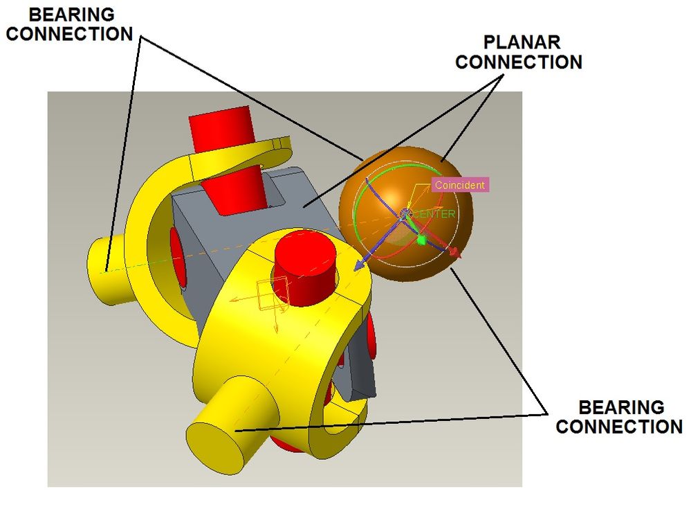

In order to get the desider result I added an extra component, which needs to be no more that a point and a plane containing that point. In the pictures I also drew a transparent sphere to make the point visible.
In order to fulfil the conditions requested in the first post, the axis of the input and output shafts must match always in a point contained in the middle plane of the grey bracket.
In order to get that, I constrained the new component (orange sphere) using 3 different set of constrains:
     1. Bearing constrain forcing the ficticious point to be located along the input shaft axis.
     2. Bearing constrain forcing the ficticious point to be located along the output shaft axis.
     3. Planar constrain forcing the ficticious point to belong to the grey frame middleplane.
Now, the goal constrains regarding angles are reached in both the current assembly and bigger ones.
