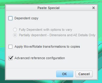

Is it possible to copy a part's geometry into a new part window? I have a gusset (gusset 1) and I need to have the same gusset but with a notch  (gusset 2). I do not want to waste time recreating the gusset from scratch if I already have its geometry.

If the gusset is a single feature or a series of features, you can actually fairly easily copy it to another location in that model or to a completely different model.
Select the features you want to copy and select copy from the ribbon or ctrl-C on the keyboard.
If you are pasting to another model, change to that window now.  Having two monitors with both models open side by side is helpful here.
Do not select paste, but instead select paste special from the drop down menu under the paste command.
In the pop up dialog, select "Advanced reference configuration" and deselect the other options.
Next, Creo will bring up a dialog box (I'm still using Creo 2, the dialog is different in Creo 3 and up so no screen shot) showing all the references used to create the feature allowing you to select new references in the new part.  If you are pasting in the same part, Creo will have selected the same existing references by default. Change the ones that you need to change.
You'll then be prompted for directions for features and sketch planes.  Assuming the geometry works, the feature should be previewed on screen and will be created once you select OK.
