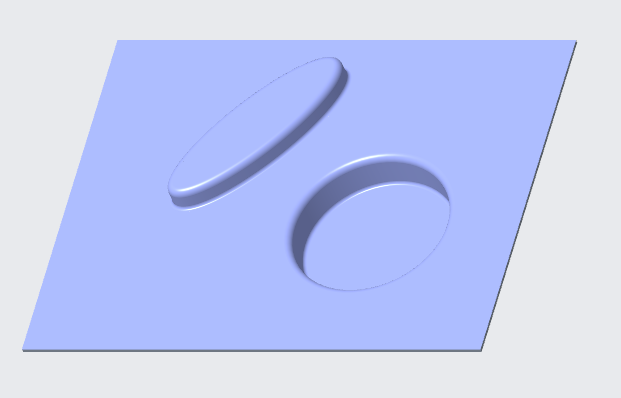

 I know it might be a weird question. I need to work in this sheet metal part. I'm creating the surfaces of the stamping die. For this i need to copy all the surfaces of this side, to start working. Today, i'm selecting the surfaces one by one, but it must be an easy way to do it. I'm used to do this in catia. In catia I would extract the surfaces with tangency continuity. Is there any option of that in creo?
You could imagine that selecting all of this surfaces one by one, is a really tedious work.

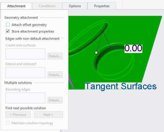

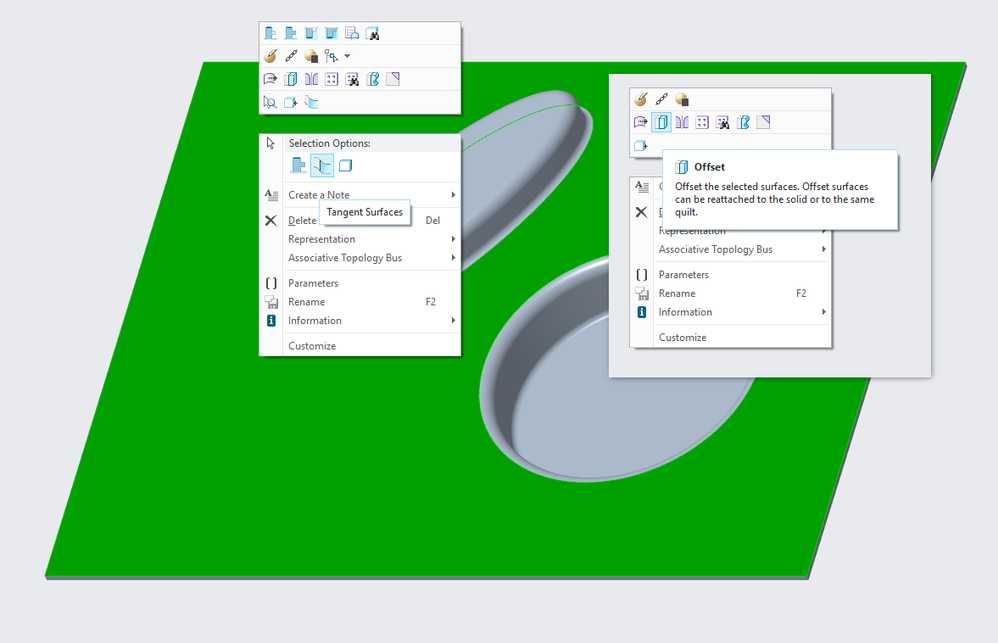

Just a little idea:
In FMX you can select tangential surfaces.
An offset (0mm) can be generated from these selected areas.
Do not attach the offset geometry.
Select tangent surfacesSelect tangent surfacesCreate offset (0mm), not attachedCreate offset (0mm), not attachedThe quiltThe quilt
