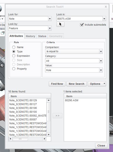

Regarding finding only hole notes, try this:
You want to look for notes by a certain type of feature, in this case hole features. I believe that will capture only the hole notes and not others.

Thanks for the tip on the type of feature (I also found the option "has thread").
