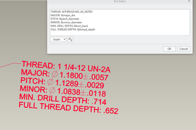

I have a UDF that creates threaded internal holes. In the UDF family table exists all the information that is needed to create a note on the drawing for describing the thread, depth etc. Is there a way to create a note from the table columns without having the user select each dimension?
Note should read as below:
1/4-20 UNF-2B
Major Dia.: .5000
Pitch Dia.: .4565/.4500
Minor Dia.: .4340/.4170
What I would like is an annotation to be created when the thread UDF is ran. The UDF may be ran several times on one part & this is the reason to need it created as the UDF is ran. This way the user can show/erase the annotations and reduce the chance of errors.

Finally figured it out!
Had to add the NID info for the Annotation to make it work properly to get the thread text. Gave up on the tolerance display but have now also figured that out. Was trying to show all as numbers. The only way I found to make it work was to use text.
