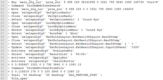

It's bit of a side question, but certainly related. My trail file is supposed to add a note to a CAD file. I tried to set it up to find and attach the note to the first coordinate system it finds in the part, however, it does not appear to succeed in finding the CS in every file. The first CS name is not always the same ID or name so I'd really like it to just pick the first one it can find in a list regardless of what it is. Below is how my trail file is selecting the CS. Essentially ctrl+F->Look for CS->History Tab->Rule=ID, Criteria ID<1000->Select the first item in the list and move on to defining the note.
However, it misses some files because it doesn't auto select the first item in the list. Is there a more robust way to pick the first coordinate system? It doesn't matter what CS it selects in the model as long as it attaches the note to a CS in the model.

the first thing that occurred to me ... (testing in Creo Parametric 4.0 M120)
1.]
Set model tree to display 1 additional column >>> Feat Type.
Save this model tree setting to tree.cfg file.
Set config.pro option ... mdl_tree_cfg_file   path_to_tree.cfg
2.]
Get your file list, generate trail_no_1.txt and play it.
trail_no_1 functionality:
Open every file from the list and save model tree contents into modelname.txt file.
Example of output file:
         Model Name          Feat Type
 AFX_PRJ_I_BEAM_1.PRT
   Materials
   YZ                        Datum Plane
   XZ                        Datum Plane
   XY                        Datum Plane
   CS0                       Coordinate System
   CS3                       Coordinate System
   CS_S                      Coordinate System
   CS_E                      Coordinate System
   Protrusion id 31          Protrusion
   A_1                       Datum Axis
   Datum Point id 1461       Datum Point
   Group PROFILE_LENGTH_DIM  Group Head
   Insert Here
3.]
Get your file list + list of model tree output files, generate trail_no_2.txt and play it.
Retrieve the name of first CSYS from model tree output file (for every model). Use the name to search/select CSYS via trail.
trail_no_2 functionality:
Open every file from the list and attach note to first CSYS.
Martin Hanák
