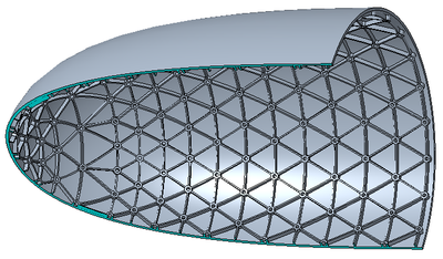

This month’s challenge is based on a modeling problem I’ve seen throughout my decades in aerospace. An isogrid is a repeating rib structure that adds strength with low additional mass. Although it may appear simple, modeling it in CAD can be difficult, especially when you need to place it on a non-planar surface.
Public domain image courtesy of NASA and Wikimedia Commons.
Your mission, if you choose to accept it, is as follows:
  • Beginner to intermediate: Model an isogrid on a flat surface.
  • Expert: create an isogrid on a cylindrical, conical, or radome surface. The isogrid can have a size / spacing of your choice and can be placed on the interior or exterior surface. (If placing on the interior, I highly recommend creating a cross section to make it visible.)
  • Optional: add fillets to the interior “vertical” edges.
For this challenge, you can choose to ignore the center circular post and hole as depicted in the pictures. You can focus on the vertical sides of the isogrid triangles. (Of course, you can always challenge yourself by including those circular posts and holes.)
How would you do this in Creo Parametric? Would you use a profile rib, trajectory rib, extruded protrusion, extruded cut, datum curves, surfaces, pattern, toroidal bend, or some other feature? (Most likely, it would be a combination of two or more of these.) The sides of the triangles in the isogrid can either be connected or they can be disjointed (as in the image below).
An optional Creo Parametric 2.0 model has been attached with a radome part model as a starting point if you choose to use it. As creating the isogrid all the way to the tip can be challenging to say the least, a suppressed Solidify feature has been included that removes it.

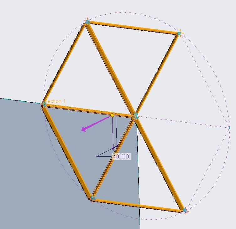

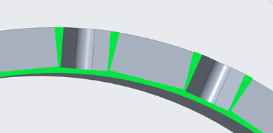

For the purposes of this exercise, I have a question about the requirements. Assuming pocket milling is used to remove material from a curved part, how must the tool path be managed when cutting the pockets? Is it acceptable to use a surface normal reference at the centroid of each pocket or must the tool trajectory be normal to the curved surface at all points along its path while milling?
This is an example of using the surface normal at the centroid of each orange 3 sided pocket on a curved surface. This topology will not be congruent to one where the cutting axis is normal to all points on the curved surface.
Involute Development, LLC
Consulting Engineers
One of the reasons isogrids are not very common is that they are incredibly expensive to manufacture. For the sake of this challenge, concentrate on the geometry and not the manufacturing method. You do not need to assume this will be manufactured via CNC machining. When evaluating the submissions, I will look at the resulting geometry and what features you chose to use. I will not be taking manufacturability into account.

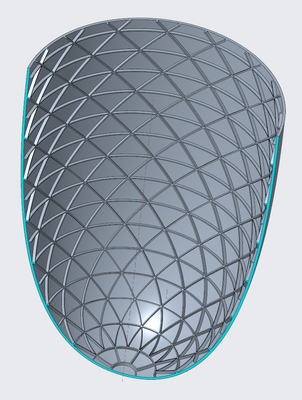

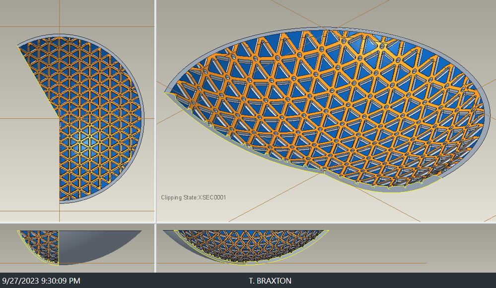

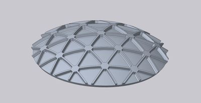

Isogrid applied to the interior of a domed shell.
Wow. Looks fantastic.
Can you share your model file with the community?
Dave Martin - dmartin@creowindchill.com - https://www.mcaeconsulting.com
tbraxton
22-Sapphire I
(To:DaveMartin)
Creo 7 model enclosed. Resume all features after opening the file and prepare to wait (1 min 50 sec regeneration time on my 11th gen i9 laptop). Fully regenerated this model zipped exceeds the 47MB file size limit for upload here. I suppressed the patterns to reduce the file size.
Notes:
There is a geometry check in the model that is embedded within a trajectory rib internal round. If anyone can offer a fix for that I would like to see it.
The patterns are structured to regenerate "quickly".  Quick is relative to other potential construction techniques. It will regenerate faster than if the auto round function were used on the pockets for example. If there are techniques that will regenerate faster than what is in this model, please post them.
Holy cow, you are truly a master! Honestly, it's been about 15 years since I've seen or even discussed using the old school technique of suppressing features or using Insert Mode for sharing files with people to cut down on file size. (It eliminates the geometry definition from being stored in the file.) That's what I love about these challenges: we get to see techniques that aren't taught in classes or best practices.

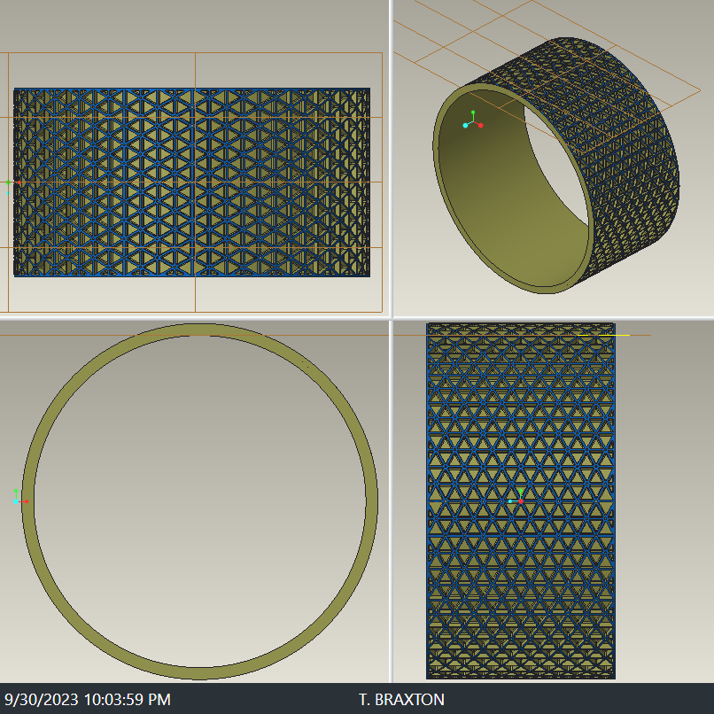

Isogrid on O.D. of cylinder. Used removal of material to create the pockets on this one.
Creo 7 model posted.

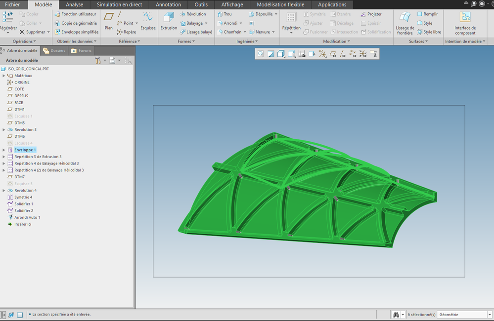

I found the exercise harder than it looks!
here my 2 first try.
Thx to Dave for this challenge .
made with creo 4

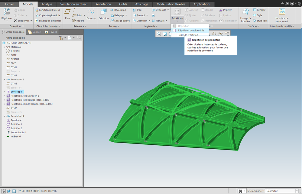

Fiddix, Can you explain how you used copy geom? I'm trying to replicate how you generated the part, but your copy geom window is different when I try to do it. I cannot select the same references that you selected.
Fiddix
6-Contributor
(To:Aaronm87)
sorry for my very late answer !
I dont do anything particular:
I just make a box selection of all the geometry and then make a "repeat geometry"
I make you 2 screen shot to illustrate.

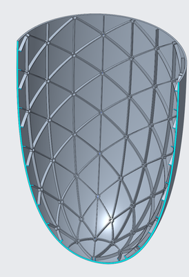

Hi Dave,
Thank for this challenge.
I think there are lot of different ways for this feature creation.

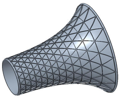

I have used on the way in non-planar, non-cylindrical, non-conical surface.
Please find below image
Part is attached. Give your feedback.
Creo 9 has been used to create this part.
Jignesh.
Your "isogrid" is different from the rest 🙂 You have intersections with 8 or 4 "beams" and the length of your "beams" are not all equal (you have short and long beams).
But it's a nice grid! 😄

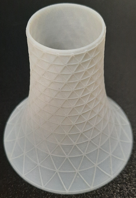

The 3D printer was in need of some "exercise" as it had been sitting idle for almost a week, so I printed a scale model about 2.5" tall.

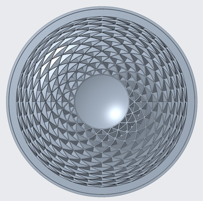

Fun challenge! I did mine in Creo 7 with some Spinal Bends and Multibody. It got a bit thin towards the bottom, which could be fixed, but I couldn't be bothered. 😄
I'm new with Creo but have used SolidWorks for 10+ years. Here's what I came up with. I created the following and the made a pattern from it. Outer ribs are half the thickness of inner ribs so that all ribs are uniform when the pattern is applied. Using Creo 9.0.4.0Challenge how.jpgChallenge results.jpg
Attaching model here
