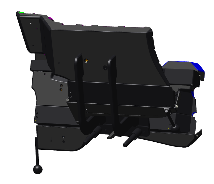

Here you can see some screenshots.
This is how the assembly looks like when opening it:

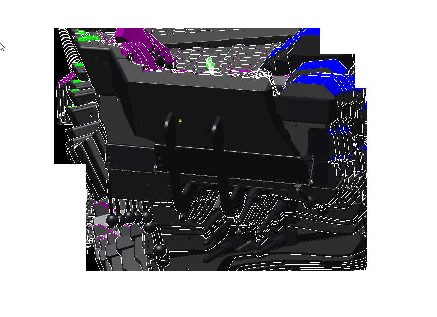

This is how the assembly looks like when hoovering over the parts:
Try these OpenGL related Creoview environment variables
    • System Environment Variables using the Control Panel > System > Advanced System Settings utility:
  PV_DISABLE_PBUFFER=true
  PV_DISABLE_MULTISAMPLE=true
  PV_DISABLE_SHADOW=true
  PV_DISABLE_MULTI_DRAW_ARRAYS=true
  PV_DISABLE_FRAMEBUFFER_OBJECT=true
 PV_DISABLE_VERTEX_BUFFER_OBJECT=true

Thanks, this solves the problem!
