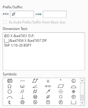

Hi Guys,
when in a drawing, i used to just double click on a dimension and it would call up box where i could add dimension text and such
Now in Creo7 I cannot as the menus have changed. (not sure when this may have changed as we jumped from Creo3 to Creo7)
If I want to edit (which I do ALOT everyday) I have to click the dimension, then go up to dimension text button to get this to happen. Wish i could double click, or even add a quick key to the mini floating toolbar, but NOPE Dimension text is grayed out. WTH
Anyone come up with any better ways to quickly access the dimension text. Sometime I could spend weeks in a drawing, and being able to double click the dimension to get the dimension text window to show would save me a TON of time. (like it used to in creo3)

Yeah that doesn't work if you use text to create your dimensions.
like:
I want my drawings to not change my part model. So i have to create each and every dimension inside the drawing.
For frequently used tasks, make yourself a mapkey!
The one below will call up that dimension dialog box from the ribbon tab.  Just select the dimension(s) and press "e" twice...
mapkey ee @MAPKEY_NAMECallUpDimensionTextDialog;\
mapkey(continued) @MAPKEY_LABELCallUpDimensionTextDialog;\
mapkey(continued) ~ Activate `main_dlg_cur` `page_Dimension_Properties_control_btn` 1;\
mapkey(continued) ~ Command `ProCmdPmaChkSldPnlDimTxt`  1;\
mapkey(continued) ~ Trail `main_dlg_cur` `Dimension_Properties:ProCmdPmaChkSldPnlDimTxt` \
mapkey(continued) `RibbonPanelsOnActivate_ProCmdPmaChkSldPnlDimTxt` ``;

If you detach the dimension text edit box you showed a picture of from the ribbon it will pop up with a single click on a dimension. Direct access to the text edit dialog in one click.
