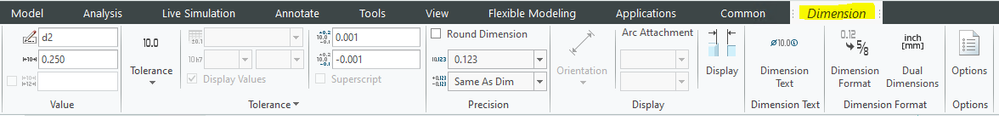

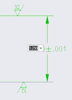

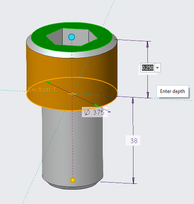

Yes, this has changed.  You can still directly edit a dimension by double clicking, but to change any of it's properties you have to use the ribbon.  This is in both model mode and drawing mode.
Part:
Drawing:
