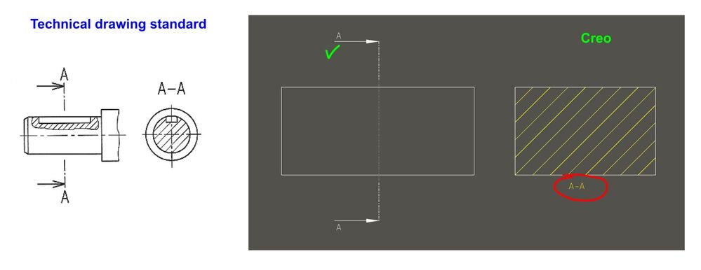

is it possible to manage default font type/size/linestyle for cross sections?
I want to follow technical drawing stadards in my country but Creo always use default font/color/linestyle for section name which is not correlating with cross section default arrow style (because it is just a note).
I am missing something like these "drawing.dtl" options:
crossec_font_color (valid for arrows and xsec note)
crossec_font_height (valid for arrows and xsec note)
8 REPLIES 8

What I want to achieve:
Ideally have an option to change height of the font as well for both (arrow+note) which is now in default size.

Option "def_view_text_height" works according to my needs.
No luck with "def_view_text_thickness" because applicable for some fonts only (for example TT fonts thickness is fixed by type of the font).
Would be nice to have "def_view_text_font" to switch for bold/italic etc. font version and also "def_view_text_color" to change font color.
