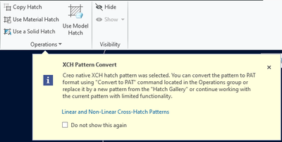

I am trying to modify the crosshatching in a part drawing section.  After selecting the area, the  "edit hatching" menu appears, but is greyed out.  Any suggestions?

In Creo 10 when I click on the section:
I have this menu pop up.
I then use the drop down to select:
then it give me option to edit:
