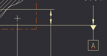

Get Duplicate Label warning about datum symbols that have been deleted.
Can DRW file be cleansed of all deleted datum symbols to not get duplicate label warning?
How it happens: I save a copy of a model I want to make a similar part of/different version. The model and drw are saved to the new file. As is there are 2 datum feature symbols(A and B) made in the 2D drawing attached to dimension leaders. I edit the geometry of the model and that ends up deleting the dimension the datum feature symbols were attached to so the symbol is as deleted and not longer in the DRW tree when returning to the DRW. Now when I try to place the datum feature symbols A and B are still consumed somehow and I get "duplicate label". I can find no way to clean the old datum feature symbols from the file.

Save copy as + deleted dimension with datum A tag + try to add tag to new displayed dimension

I was given a workaround fix by PTC support. I have successfully cleared the duplicate label from multiple drawings.
https://www.ptc.com/en/support/article/CS324109
There is a magic DRW DTL option that does the trick
update_drawing 10097712
This gets applied and then disappears from the DRW DTL option list after closing detail options once. Have to get the symbols to refresh. Then Review tab > Update Sheets. At this point the duplicate label warning is gone but there is still a red line under datums. Regen. Still?. Click on symbol to highlight then click in open space. Still? change datum letter to something else them back again. It better have gotten rid of the red line by now. just attack it with every update and refresh you know.

Appeared in Creo 10.0.0.0 and could be solved with your given solution.
I also have a work around for this.  You don't have to go offline or have a specific version of Creo...
The drawing in question has one or more Duplicate Label errors for newly created datum feature symbol(s).
Start a new drawing, Import > Drawing/Data, select the drawing in question.
Save the New Drawing; close and erase the drawing in question.  Save A Copy of the New Drawing; Select the drawing in question to overwrite, confirm that an object with the same name already exists in workspace.  Close/Erase all,  Open the drawing, delete unnecessary sheets, et cetera.

If the datum tag is still in the tree that is a different form of the issue. I see in CS285444 the datums tags are under the gtol still there to be deleted/fixed. My original issue was there was nothing in the tree left to edit/fix. Similar issues divided by nuisance.
