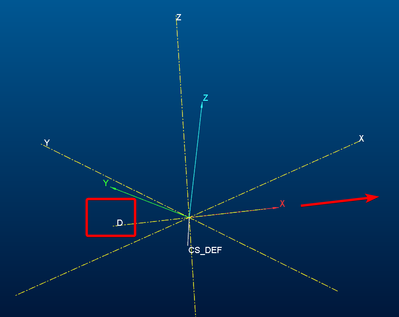

I have to create three Datum Axes with name D, E, F, based on a custom Coordinate System ("CS_DEF"), which is rotated relative to the original (XYZ) coordinate system.
My problem is that, if I create a Datum Axis based on the axis of the coordinate system, Creo puts the axis name on the opposite side of the direction of the coordinate system's axes.
How can I move the name of the axis to the opposite side?
thank you

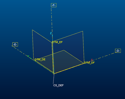

I got a lot of useful ideas, and in the end, one plus one idea became the most useful for me 🙂
- Creating CSYS based on the default or previous CSYS (easy to set the origin and orientation)
- Define 3 planes based on the new CSYS's axes
- Define 3 datum axes based on the three new planes, setting their size
The selecting order of planes affects where the label is positioned on the resulting datum axis.
The positive sides of this method:
- Sketch references and mates refer with the correct name of axes
- I realized afterwards that I should have used the created planes for sketch anyway
Created objects: CSYS, Planes, Axes
After hiding CSYS and planes, clear and nice:

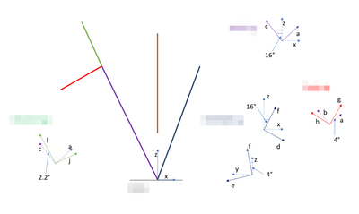

Unfortunatelly only renaming the CSYS feature doesn't help me, because as I mentioned I have to see the (other than XYZ) name of the CSYS axes names and directions in the modelling space. I get the optic design plans in PDF, and there are multiple light path branches where the angles and relations are defined with it's own coordinate systems. For example Pattern laser is defined in ABC csys, pattern rec is defined in DEF csys so on..
Based on the plans received from the opticians, I sketch the individual light paths in 3D, and this creates a skeleton model on which the real 3D geometry is based.
To compare the directions given in the received documentation with as few errors as possible, I need to see the same axis names in the model as in the documentation. See an example on the image below

I think we are clear on what you want but Creo does not support it, so then it becomes a search for a good alternative. You are right to try and set it up so that it is easy to understand based on the inputs you are working from to capture the design intent.
I design optical components and work with ray tracing for lenses, light pipes etc. so I have some experience dealing with this type of thing. If you need to design around a collimated beam as an input, then I would create in your skeleton models 3D curves that represent the input vectors provided by the optical team. You can define the direction graphically by adding the tip of the vector in the sketch. I would still create the csys features and name them A, B, ... you can then use each of these reference frames (Csys) to create 3D curves (sketches if possible) to define the unit vectors for radiation directions within a sketch you can add text to label these vectors with any character required.

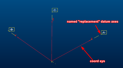

Here is an option:
Coordinate system
Offset points and named them as needed.
Curves by point and changed the colors.
Could make into a UDF to make creation easy
Thank you everyone for help.

@NG_12013596 Nice solution...don't forget to mark your response as the solution.
Out of curiosity, I tested the axis creation based on datum selection order...it's a nice trick to get the label where you want it. I don't know where I can use it but it might come in handy one day!
