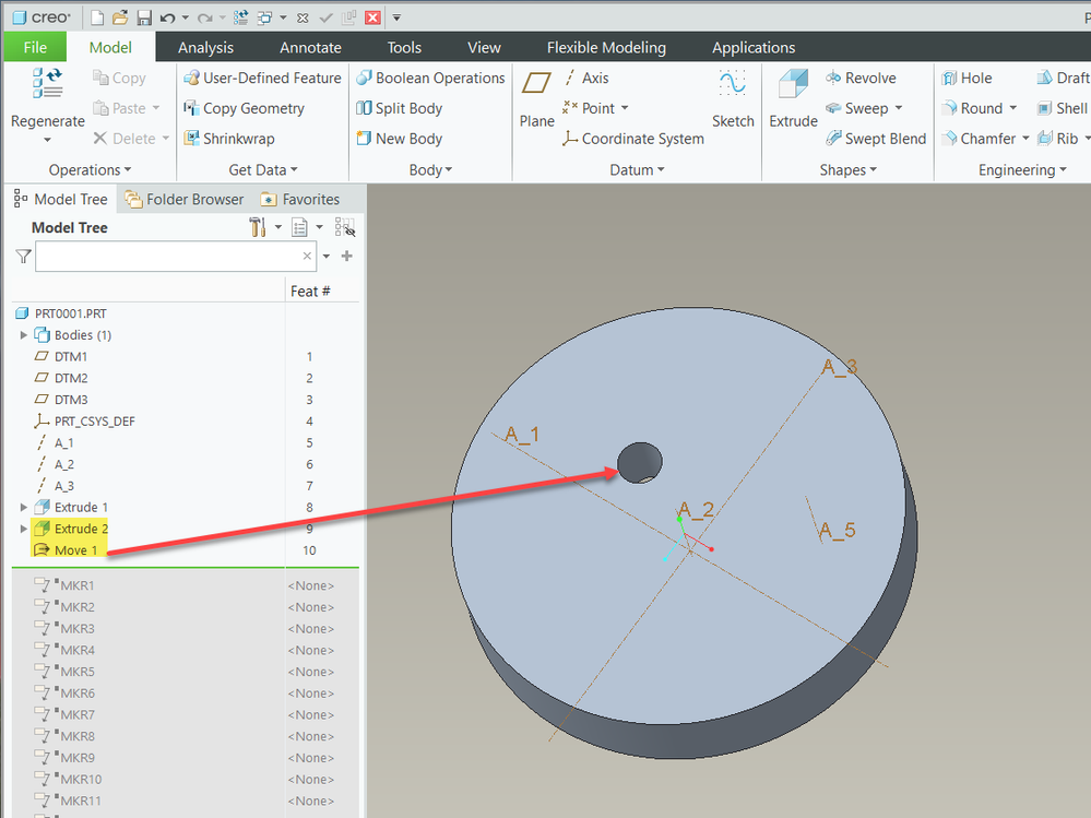

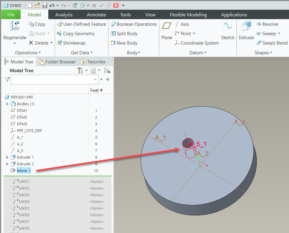

If I am understanding your request correctly, you can hide the axes using layers, but you will not be able to delete them from the model without deleting the feature that is their parent. You do have the option of moving the axis using the flexible move function (see last pic below), this will effectively hide the axes you want to delete when the flexible modeling move is regenerated,

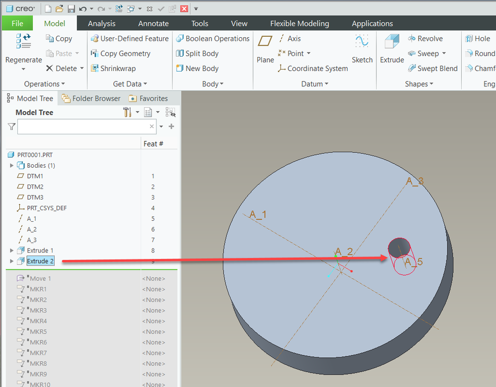

You are not able to remove the axis in this scenario due to the existence of a feature that is a parent to the Flexible move or remove operation that is still part of the history of the model. There is a hybrid modeling paradigm when using flexible features such that the parametric feature history is preserved. This can be seen in the pictures below where the axis is persistent. A flexible move is used to shift the location of the circular cut but the axis of extrude 2 remains in the location where the extrude was defined.

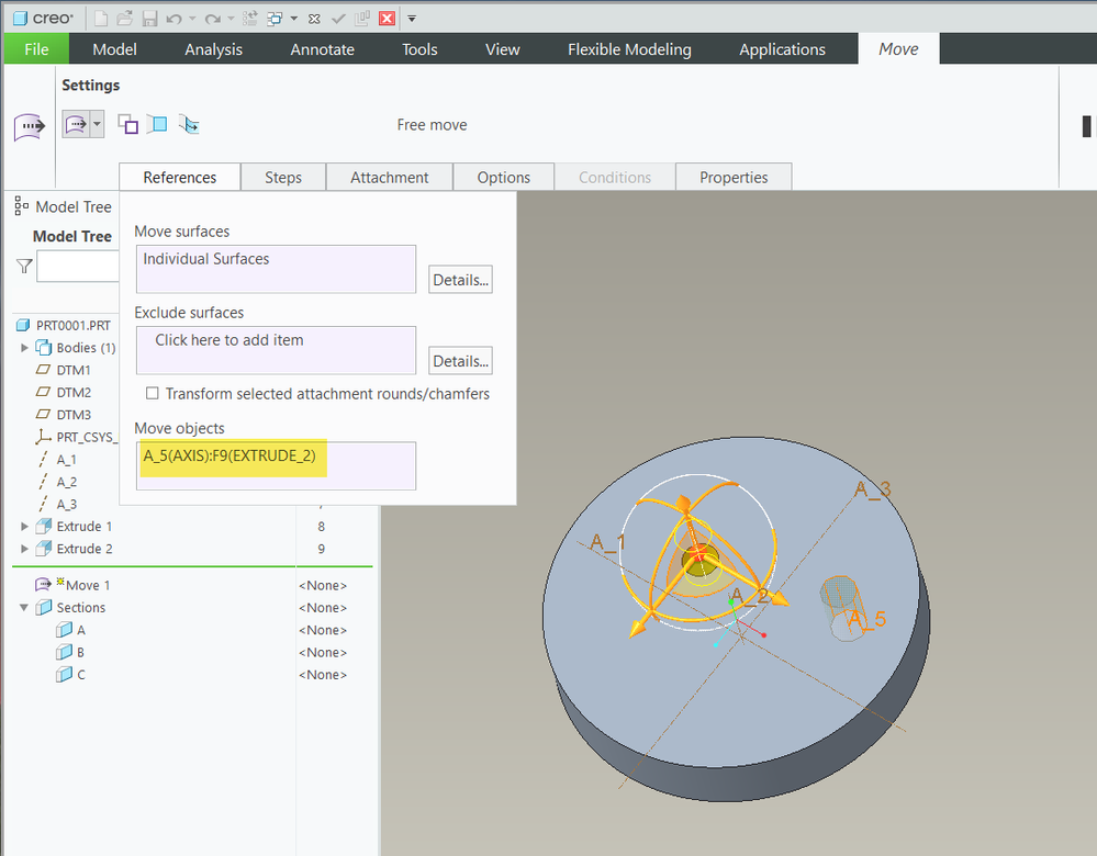

You can resolve this by using the move objects selection in the flexible move command.
