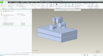

I have an assembly with a rotating component. Other users want to open CAD assemblies with depictions of this component at its limits of travel. There is also a need to calculate the CG of the assembly with the component at its limits of travel.
I am aware of "Explode State", but there are two reasons why it is not a complete solution:
1) the other users have minimal training and are not aware of how to activate or use the Explode State function.
2) the need to calculate CG of the assembly requires that it be actually positioned at the limits of travel, and Explode State is only visual.

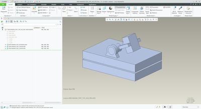

I can use Family Tables with the component positioned using Angle Offset, but I can't figure out how to get Family Table to affect dimensions of lower-level assemblies.  The result is that the bearing housings on the component rotate as well and are not oriented correctly.
How would you suggest I resolve this issue?  The greatly-preferred method would be something involving Family Tables, so that users get a dialog when opening the assembly and do not need to perform secondary activities like setting Combined Views or Explode States.  Duplicating parts and using Simplified Reps to turn "extra" items off is greatly not preferred because it interferes with PDMLink BOM generation.

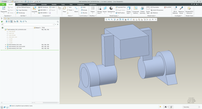

Rotating component with bearing housings:
Top assembly with baseplate:
What I am able to do with a Family Table and Angle Offset of the rotating component:

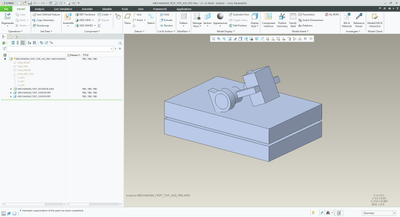

What I would like to see when I open the Family Table "rotated" instance, preferably without needing to also set an Explode State:

If you want to do it with nested family tables then you need to make instances of the lower level components. You can then make a family table at the top level that allows the component to vary and then you paste in the lower level component instance name.

Thank you for the reply.  It had occurred to me that I could use nested family tables (varying the dimension at the lower level, and the component at the upper levels) but I was hoping for a solution that was top-down rather than bottom-up.  But that method would definitely be transparent to the intended users, which is a major goal of this effort.
