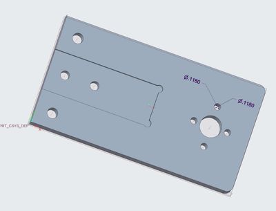

The picture shows the "ears" I add to rectangular depressions in a part so that the fillet left by the milling cutter will be removed and I can bolt a rectangular part with sharp edges into the depression.
Is there some better way to handle this problem in Creo?  What do you do?

If this is something you need often then I would suggest creating a user defined feature (UDF). You can include the pocket and the corner cuts in the UDF and then place it in models as required. You can create a library of different sizes or use one UDF and edit the dimensions after placement. See subordinate and stand-alone UDF options.

It's really about what your mating part looks like. If I was in control of the mating component, I would prefer to add a chamfer or radius to the other part that clears my expected or specfied corner radii on this part.
jferguson4
(To:StephenW)
I agree that it would be better to radius the mating part, but in this instance, it would be more difficult that adding the 'ears'

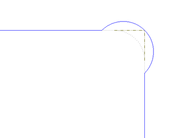

Minimal Corner ReliefMinimal Corner Relief
I've built things where I wanted to minimize the depth I'd cut out of the wall to relieve the corners, and the above "trick" worked really well for me. The presumption is that I'm going to be cutting the pocket or whatever with a specific diameter tool, so I cut any possible interference out of the resultant corners with the minimum material depth normal to the wall faces. Works well when I have ample wall length to interface with the mating part, not such a good idea with shorter walls.

Ken, How did you do it?  Two arcs? I did mine by adding a circle with center inside the corner, then reducing the offsets from each die until I got the geometry I was seeking and deleted the extra line segments.  It's funny that SheetCAM, a program I use for running the CNC router offers this as a toggle, which can be a real time-saver when doing a sheet with a lot of cutouts which require the corners not to be radiused.
