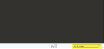

What is the selection filter set to when you are having difficulty in sketch mode? It should be set to "all sketcher" but it is possible that it may not be.
Involute Development, LLC
Consulting Engineers
This problem typically happens when trying to apply dimensions or reference dimensions, at which point the selection filter is set to "All."
