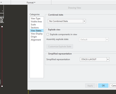

If you want the model to not show components, you can used simplified reps and you can use reps in drawing views. You can go to view properties, view states, and then select the simplified rep you want active in that view.
But as kdirth says, if you are using repeat region BOM balloons, this may cause problems.
