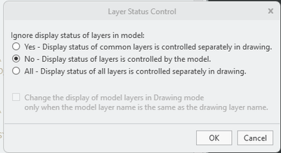

Hello Team,
I am facing drawing layer issue in my drawing. i have hidden all the layers and isolate drawing display layers but when i try to save status, doesn't allow me and asking to check out the loverlevel assembly which is released.
 the lower-level components are released, and layers are not hidden for axis.
can we control those layers in Creo drawing layers?
You need to select Yes to ignore the model status and control layers separately in the drawing.

What settings do you have for the Drawing Layer Status Control?
Here is what I have on my drawings:

this is my current drawing layer status

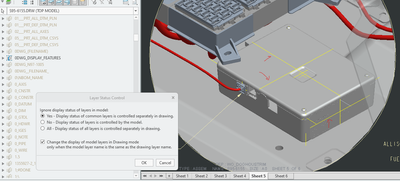

(To:kdirth)
i changed the setting and hide layers but still same issue
