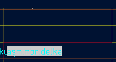

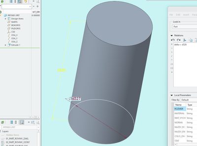

I tested it once again and managed to do exactly what you want, its suprisingly pretty easy
1, Create relation for length of your profile IN PART not in assembly
2, In the table put in &asm.mbr.delka in new collum (or you can combine everything in first collum like [&asm.mbr.ptc_common_name - &asm.mbr.delka]
3, profit

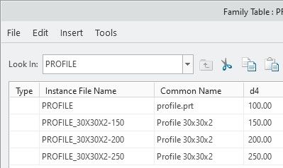

Here is an example part with family table for the 3 example variations.
Van_AG
(To:KB_11240762)
In the family table of profile.prt add a variable parameter (for example, ptc_common_name as the profile name) and a variable dimension (for example, d4 as the profile length).
See pic1.

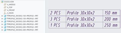

In the drawing
Create a 1 row/3 column table.
Create a repeat region with type "Simple" for all three cells.
Set attribute "No Duplicates" for the repeat region.
Type in cells
1st: &rpt.qty PCS
2nd: &asm.mbr.ptc_common_name
3rd: &asm.mbr.d4 mm
See pic2 (symbol "&" not displayed but exist in cells).
And for result see pic3.
3, profit
It works! Thank you so much!
