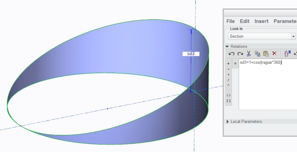

A line with variable length: sd3=1+cos(trajpar*360) - the value statement "1+" is to ensure no negative value exists. The value of cos(trajpar*360) is +1 to -1 and back to +1 (90 degree ofset sine wave). So the line is 2 long at the start; 0 long at 50% along the trajectory; and back to 2 at the end.
A circle with a variable diameter: As in the line above, the circle diameter is 2 to 0 to 2 again.

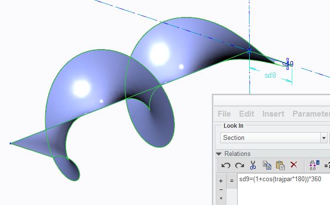

Revolving a line along a closed trajectory is little more complex, apparently. The reason for this is not immediately apparent. In this case, the value range is 1 to -1 and not back to 1 (half the cosine wave). Also, the full range -must- convert to "360" or multiples there-of. The same "1+..." statement is to convert the value range from 2 to 0 (all positive or zero). The "...*180" makes the value range 0 to 360. But also notice the "cos(trajpar*180)". In this instance, we only want one direction of rotation from 360 to 0. This is the special condition where 360=0 and therefore abides by the basic rule #1; the end condition must be the same as the beginning. Any other value in this statement that does not result in a value following rule #1 -will- fail. However, this particular closed loop with a revolving section does not require a sine function. In fact, you can revolve the line linearly using "d(n)=trajpar*360". Again, for the very reason that this range of 0 degrees to 360 degrees create the same end condition as the start condition. Try replacing "...360" with "d(n)=trajpar*(360*20)" in the Relation for multiple loops around the trajectory path similar to the next example.

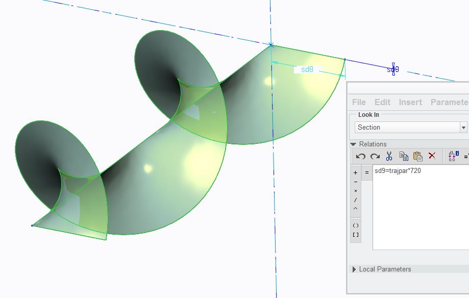

of course, these are simplified examples but the power of these equations should be self-evident. The following examples show that angles with values greater than 360 are allowed: sd9=trajpar*720...
In this instance, the open trajectory uses "trajpar" directly using the value 0 to 1. sd9 is an angle dimension where at the start of the trajectory "0*720=0" and at the end, "1*720=720". This creates 2 full rotations of the line defined by sd8. Now see what happens is you replace this with a curve function by replacing the sd9 statement with "sd9=(1+cos(trajpar*180))*360". Notice how the ends are now beautifully tangent to a horizontal plane.

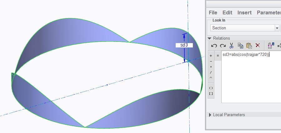

There are endless solutions that can create some very specialized section geometry, not to mention the multitude of applicable trajectories. Here is another way to remove the "-1" aspect of the sine wave. In the case - sd3=abs(cos(trajpar*720)) ...includes 2 cosine waves with all the negative values inversed with the abs() function. Again, zero is encountered 4 times.
