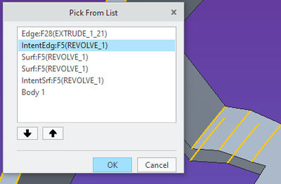

I have not worked with lattice features, but I would expect that you could select an IntentEdg.
There are two methods:
  • with mouse over edge, use RMB clicks to cycle though possible selections and LMB.
  • with mouse over edge, use long RMB and select pick from list icon then select the IntentEdg wanted.

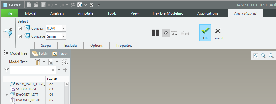

Auto-round feature may work. Without access to the model, it is hard to determine options. It is scope limiting functionality options.
Involute Development, LLC
Consulting Engineers
This is a good question.
Are you free to share the Creo model - or a simplified version of it?
We might be able to provide more help.
One possibility (without seeing the model) may be to roll back to the point where the intersection exists, then apply auto-round, eliminating autoround affecting all the unwanted areas.
