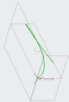

Situation no.1
!       DATUM POINT ARRAY DATA FILE
! Comment lines should begin with an exclamation mark (!).
! You may have as many comment lines as you wish.
! There must be at least one space between values.
! Enter values with respect to datum arrays' coordinate system:
!CARTESIAN coordinates:
!        X                Y                Z
           0.00            0.00            0.00
          10.00           10.00            0.00
          20.00          100.00            0.00

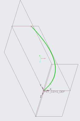

Situation no.2
!        X                Y                Z
           0.00            0.00            0.00
          10.00           10.00            0.00
          20.00          100.00            0.00
          30.00           30.00            0.00
To be able to do this change, following trail file has to be generated and replayed.
Note: Below shown trail file works for my part, only.
!trail file version No. 1961
!Creo  TM  7.0  (c) 2023 by PTC Inc.  All Rights Reserved.
~ Select `main_dlg_cur` `PHTLeft.AssyTree` 1 `node3`
!Datum Point id 40
~ Command `ProCmdRedefine@PopupMenuTree`
!ODUI session starting: Okit widgets are on, Undo/Redo on, Dashboard style off, Tab style on. Feature title : Datum Point
!ODUI session started.
!%CPSelect coordinate system to place points.
~ Activate `Odui_Dlg_00` `t1.UpdateBtn`
!results of editing PRT_CSYS_DEF.pts.1
@ edit
^!       DATUM POINT ARRAY DATA FILE
^! Comment lines should begin with an exclamation mark (!).
^! You may have as many comment lines as you wish.
^! There must be at least one space between values.
^! Enter values with respect to datum arrays' coordinate system:
^!CARTESIAN coordinates:
^!        X                Y                Z
^           0.00            0.00            0.00
^          10.00           10.00            0.00
^          20.00          100.00            0.00
^          30.00           30.00            0.00
@ endedit
~ Trigger `Odui_Dlg_00` `t1.CSysCollectorTbl` 2 `0` `c1`
~ Trigger `Odui_Dlg_00` `t1.CSysCollectorTbl` 2 `` ``
~ Move `Odui_Dlg_00` `Odui_Dlg_00` 2 28.957465 3.246038
~ Activate `Odui_Dlg_00` `stdbtn_1`
!ODUI session finished.
!ProgressBarDlg: Regen Started
Creo 7.0 model attached.
